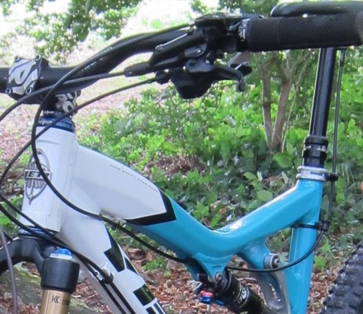

My old Yeti had a cable tie on the back of the seatpost. A glob of Sugru inbetween the suspension plates and a stick on cable guide under the downtube. The stick on cable guide eventually fell off, so another cable tie was used.
I swapped back to the sticky one to sell it cos it looked neater. Don't know how long that'll last!
