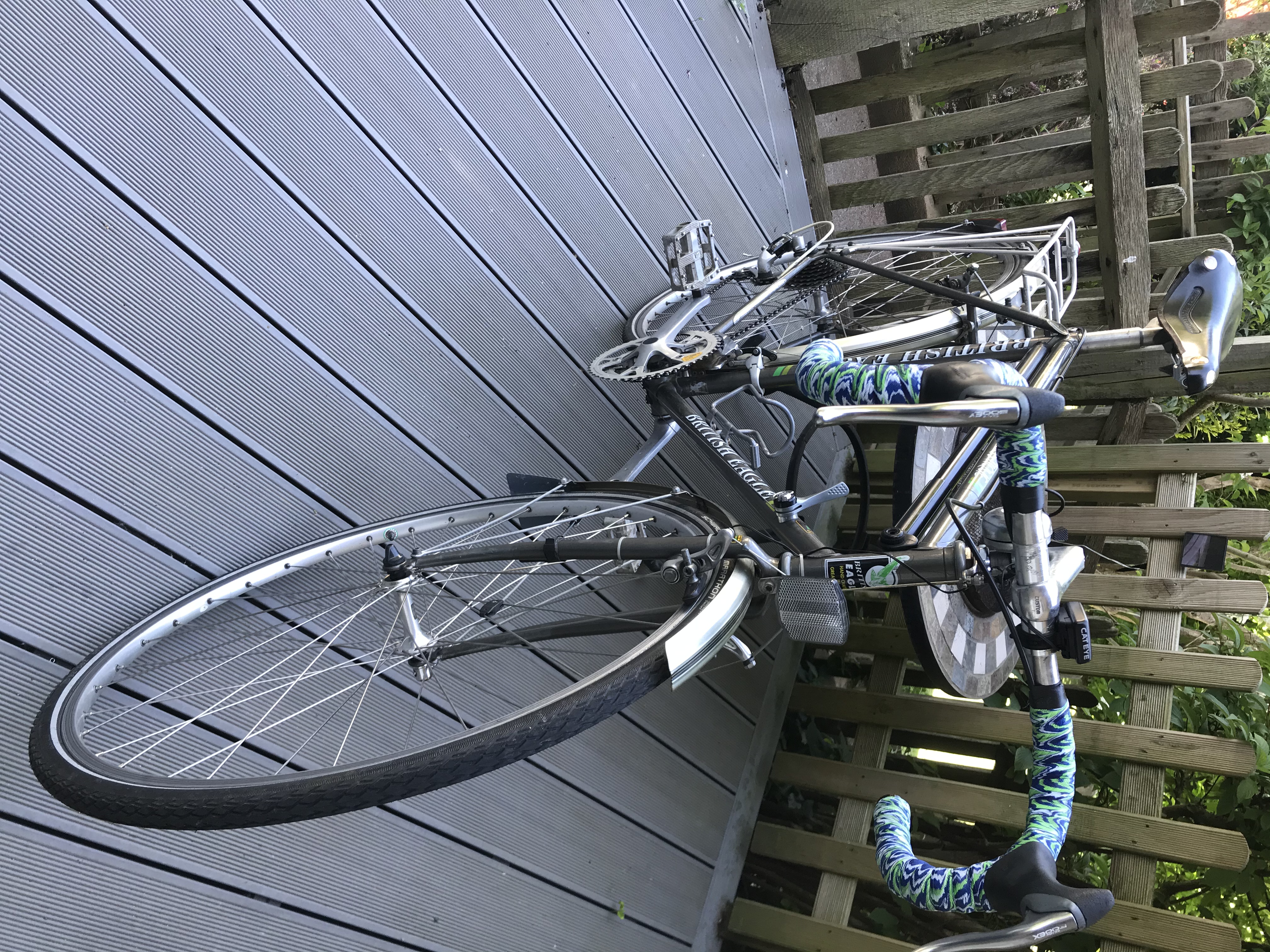

Another option is grabbing a VGC 1980s/90s touring bike (ie older Dawes Galaxy, or CB Dalesman, Raleigh Randonneur, etc. Look for triples with MTB gearing and cantis preferably.
Fit some aero-levers, some fat bar-tape, some RX5 mini-Vs, 28c Marathon Plus tyres (or 35c if there’s room, if not see if can crimp chainstays etc)
Hey presto a very nice bike for about £300 tops.
Here’s what I’m working on:
Just awaiting the mini-vs to come, then going to fit those, strip the rack and guards, fit 35cs and hopefully enjoy the rest of the summer zipping around like that. It rides gravel very well on these 28cs, surprisingly. It’s putting my Longitude out of business for general biking because
1. Covers a lot of distance quickly (genuinely surprises me)
2. Sublime ride-quality, silent and smooth.
3. Addictive to own, admire, research and faff about with.
Posted : 02/06/2020 11:13 pm
