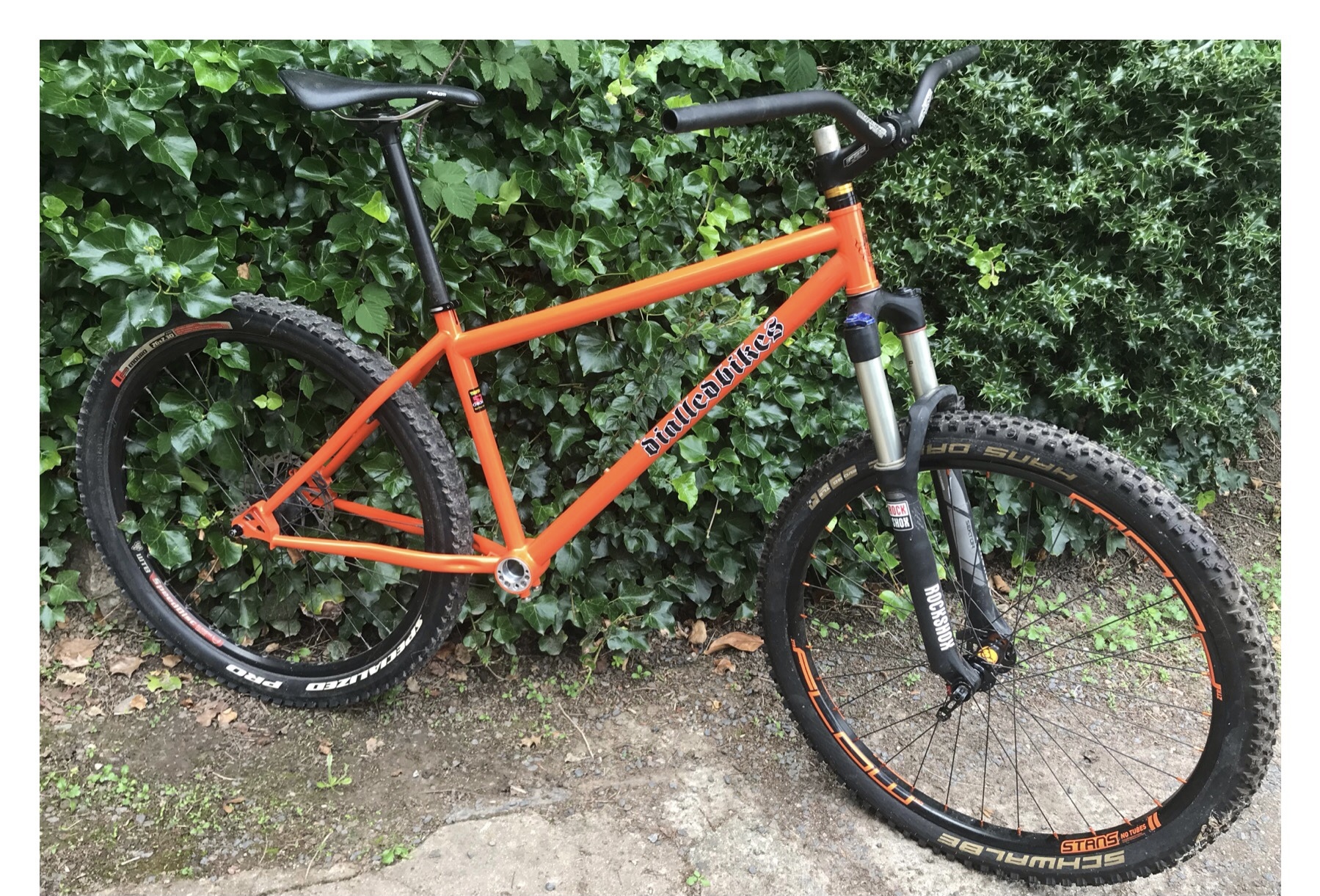

Parts bin rolling chassis shoved together today, can’t try compressing the forks properly until fitted but they are sitting on the lower end of the DP so around 120mm at a guess. There are some (Alivio) square taper cranks and ring to go on, some old Avid Juicy 3 brakes, so nearly there, just a chain and brake service, B/B and headset.
Doesn’t look too mad? I reckon that BB height is enough tho, even without a headset 😑 Exciting times as haven’t been MTBing proper (with sus forks) for a couple of years now.
