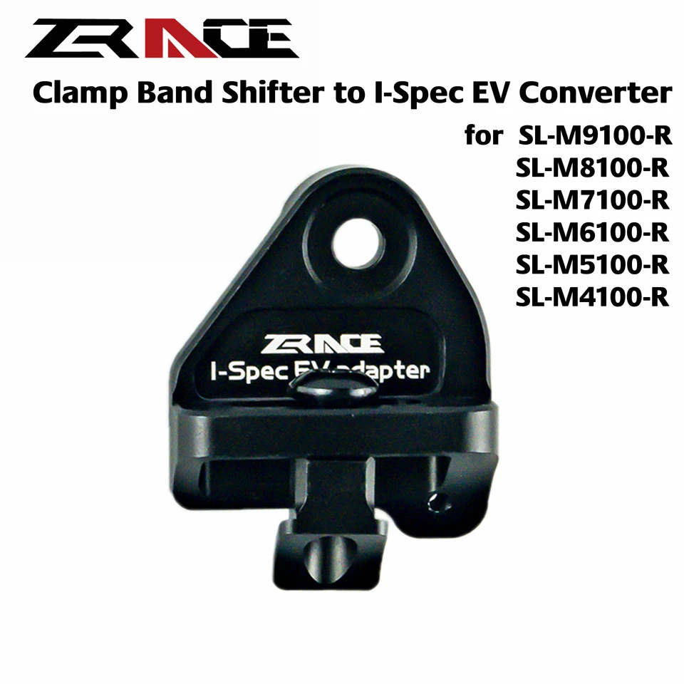

Some shifters can be converted. Unfortunately there's a catch, it must have a band-on top cover to use the adapter!
ZRACE, XTR XT SLX DEORE Clamp Band shifter to I-Spec EV converter, for  SL-M9100 M8100 M7100 M6100 M5100 M4100 - AliExpress

Posts: 98
@chestercopperpot, i descended this way into madness too. Used one of those zrace adaptors. The trouble I found was then the whole shifter wanted to rotate as there was only a single central point of contact.
in the end I just bought a new shifter as I should have done from the off.
