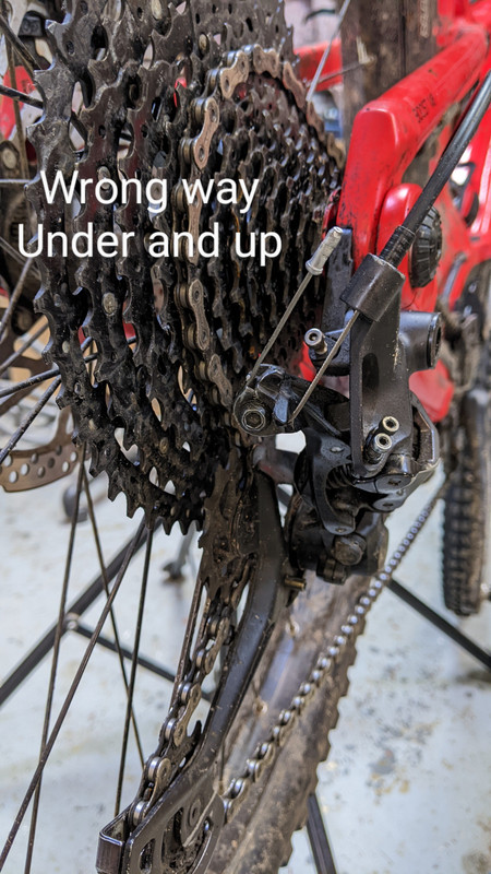

Well, full disclosure. I'm not too proud to admit that sometimes I'm an idiot and I'm laying my idiocy bare for all to see here just in case it should help someone equally distracted in the future! 😂🙄😂
I can honestly say I've never had this issue in all my biking years so I'm stoked to break new ground...
Top marks go to Oceanskipper who correctly advised that I check the cable routing into the mech.
It turns out that I had NOT got it the right way.
I've fixed it the other way now and everything is working perfectly...
Here are the two variations.
Firstly, this is the wrong way and it's the way that I had it.
In my defence, the bike was upside down and to me, it actually seems like the more obvious routing as it's straighter from the cable stop to entry.
And this is the correct way, which has cured the skipping.
You see, to me, it doesn't immediately look like the natural route but there you go...
Looking closer at it, you can actually see a tiny little curved lead-in channel. I expect this might be in the documentation that comes with it that nobody in history has ever read...
So thanks to everyone who tried to help but the biggest shout going out to @oceanskipper who gets 12 points, one for each speed I now have, and a lovely warm feeling! 😂
I owe you a cup of tea. 👊
Most of all though, to me, I give a 🙄
Posted : 18/03/2022 8:44 am

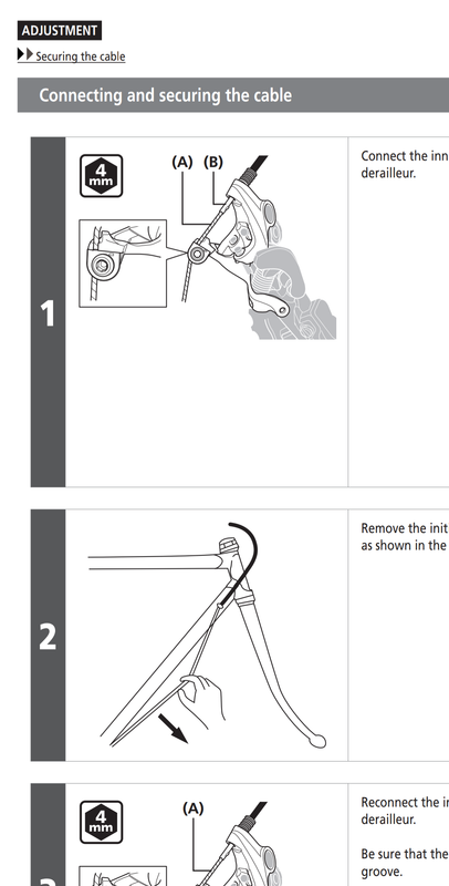

Here is the illustration in the Shimano xt manual.
It looks nice and straight in their illustration. Not so much like my reality but...meh, it works.
Literally nobody reads them though...
Posted : 18/03/2022 11:15 am

The last time I had rubbish shifting (and still do) was/is because when assembling the shimano cassette I dropped the stupid spacers, got them mixed up, put the wrong one in between 9 & 10, cross threaded the lock ring because it's a ridiculous fine thread on a light soft ally lock ring going into a hard freehub which despite doing the initial threading with my fingers cross threaded EVERY TIME, destroyed the thread on the lockring, had to salvage one from an old cassette and when I realised was too scared to remove it to fix the issue. Now I just avoid those gears and will until the cassette dies.
