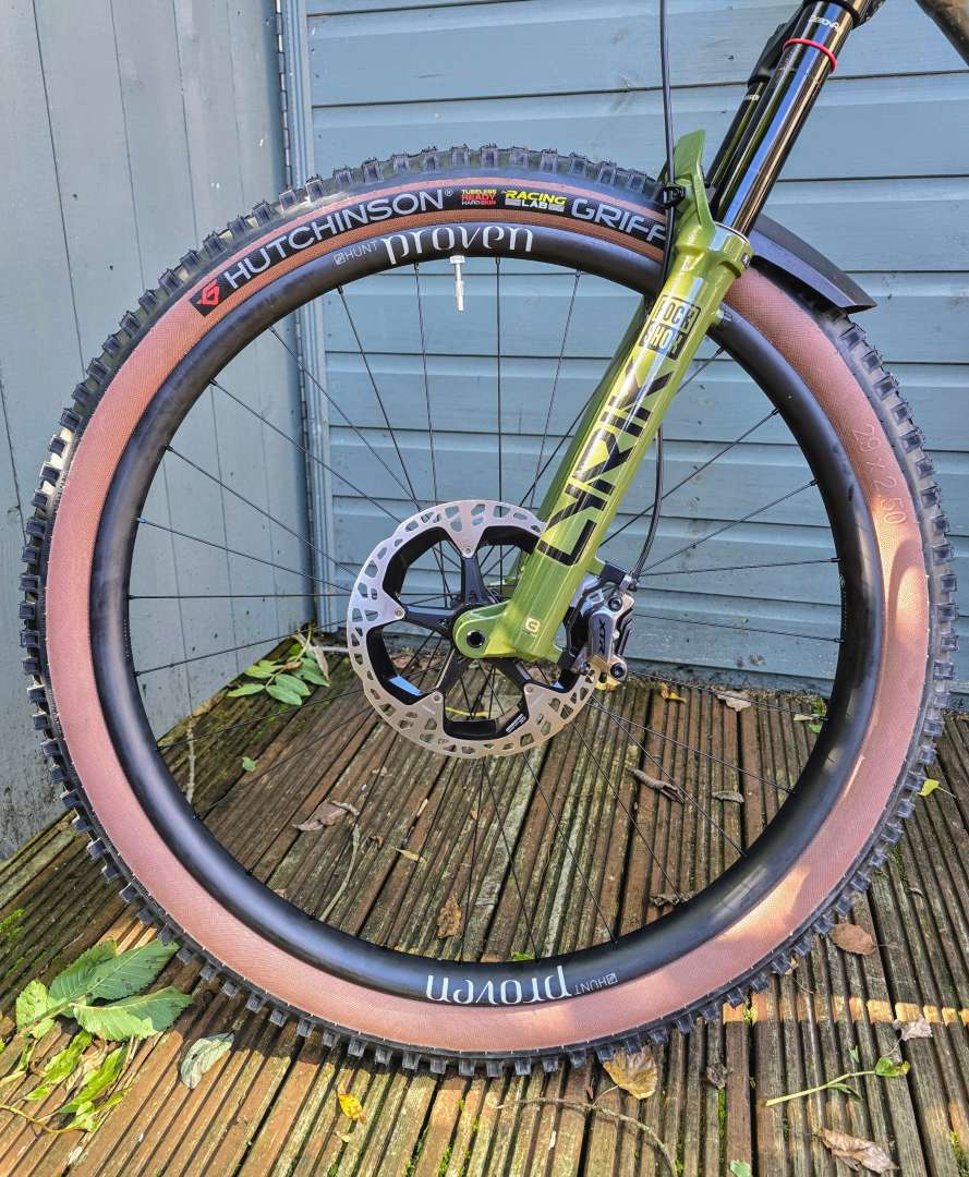

I've bought some Hunt Proven Carbon Trail H-Core wheels - reduced to £850.
Getting aside from everyone saying 'what have you bought Hunts for?' - they ask you what end caps you want and can specify RS Torque caps, so I did.
Their hubs are Centre Lock
Torque caps don't fit with Centre Lock as far as I can see.
I've got the wheels fitted, sans Torque Caps, but what was the point in offering them, never mind sending them?

It seems that the rotor needs to be removed to allow the end cap to be fitted:
https://help.huntbikewheels.com/support/solutions/articles/43000692380-rockshox-torque-cap-installation

Well torque caps are wide at the fork interface, maybe wider than a centrelock mount (haven't got both to hand right now)...so disks on first then torque caps after?

The Torque cap is a larger diameter than the hole in the lockring

Are your lock rings the older style that tighten with a cassette tool? If so you'll need those that go on with an HT2 style tool.

I've just done some digging and I was indeed being thick.

seem to recall the disc side cap on my proven wheels was a 2 piece affair  ! disc off, smaller bit in the wheel, disc on, fit bigger bit - or something along those lines .... 😉

Yes, that's what I've just found out 😆
