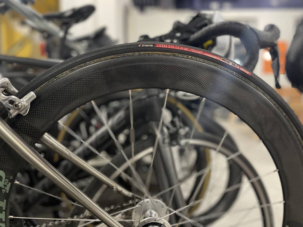

Just rebuilt a 30 year old zipp 440 rim onto a DT track hub. The angle of the nipples wasn’t too bad. No dishing for a symmetric wheel, modest spoke tension by ear, which was the reason most early carbon rims failed. And it didn’t kill me when I rode it either. Sadly it’s 21 mm tubular so I’ll just be riding it on the track.
I am getting a quote from DCR for their own (maybe) carbon rims laced to Royce low flange hubs for road riding. Hunt don’t sell fixed wheel, and I had presumed they were generic carbon rims with novatech hubs  Royce are something else  it’s also hard to find low spoke hole non track fixed hubs for carbon rims  hence the wheel below is 28 hole DT track
Wheel
