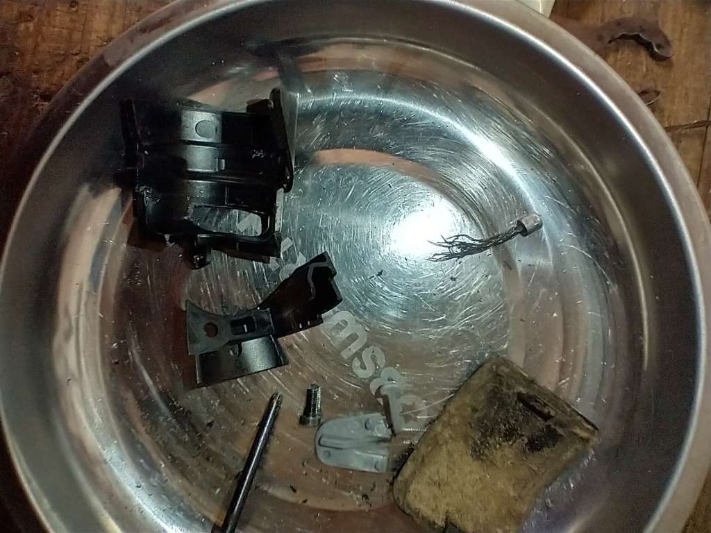

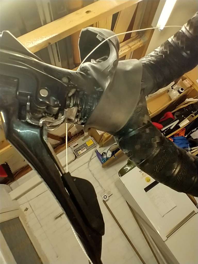

Hi,
I snapped the gear cable on my road bike yesterday.
When I went to replace it it has snapped inside the shifter. While faffing about trying to get it out I've moved it further round the shifter.
Any suggestions as to how to get it out?
The head of the cable is inside the shifter with 1cm ( think) of frayed gear wire stopping the shifter returning to highest gear.
Also it's internal routing. When I pulled the cable out I assumed there would be cables or guide tubes or something inside the frame. It seems like it's empty space.
I assume after getting the cable out the shifter getting the cable routed inside the frame will also be painful.
Any suggestions as to how to get the shifter cable re routed?

My old 105s were terrible for this - there was cover plate underneath the shifter that gave slightly more access to the Internals, then with lots of wiggling and some needle nosed pliers it'd eventually come out. I've now got Di2!

Yeah it’s easy- there is a cap over where the bend is, (on the stem side) pop that off then pull the brake a little otherwise it doesn’t line up- then poke through there.

I had similar on my last Defy, spent ages fiddling with it, eventually took to LBS who is a Giant dealer, they stripped it down and got the old bit out and recabled with the clever magnet thing for drawing cables through the frame.

Make sure you shift to the lowest gear (press the smaller lever) - may not turn back as the cable is snapped, but get some needle nose pliers to help get the ratchet back to the bottom gear. It's a faff.

I managed to dislodge the cable end on a grx shifter recently causing it to get stuck and jam the shift mechanism. To free it needed to wiggle end via the access plate on the other side and manipulate via the cable head hole using a small screwdriver until it came free.

If its well and truly stuck !  Pull back the rubber hood from the back of the shifter then on the underside of the shifter you'll see a plastic cover with a small phillips screw, undo said screw then you will find that the plastic cover will pull off giving you full access to the shifter assembly reverse the process  to put it back together, Job done !

Had the same. Cable frayed inside the shifter too and jammed it up. Shift to highest gear - smallest sprocket (if you can) to move the cam around, then remove the small plate on the inside of the front of the shifter (don't lose the screw) and fish the parts of the cable out. It worked for me. It was fiddly though.

I saw online advice to sharpen and shape an old spoke to fit down the hole and push the old bit of cable out
Well worth the time and effort on the spoke, which wasn’t much

The current crop of Shimano shifters are apparently quite notorious for snapping cables right inside the mechanism, something to do with the last 1-2cm of routing which can snag on a piece of the shifter and wear away gradually. Everything remains fine until it snaps. It's almost invariably the RH shifter which fails cos it obviously sees far more shifts than the LH.
A magnet to guide the replacement cable through the frame is very useful. Sharpened spoke or similar for prying out all the bits of frayed/snapped cable from the inside of the shifter.

I ot the cable out of the shifter, thanks for the dead up on the cable covers. .
I managed to get a bit of fishing like into the frame and out the bb, but then when I put the cable through I couldn't get the cable out
I did think that internal cables was going to be irritating when I bought this bike
I'll not be buying anything with internal routing in the futureIMG_20241121_173152306_HDRIMG_20241121_173138973_HDR
