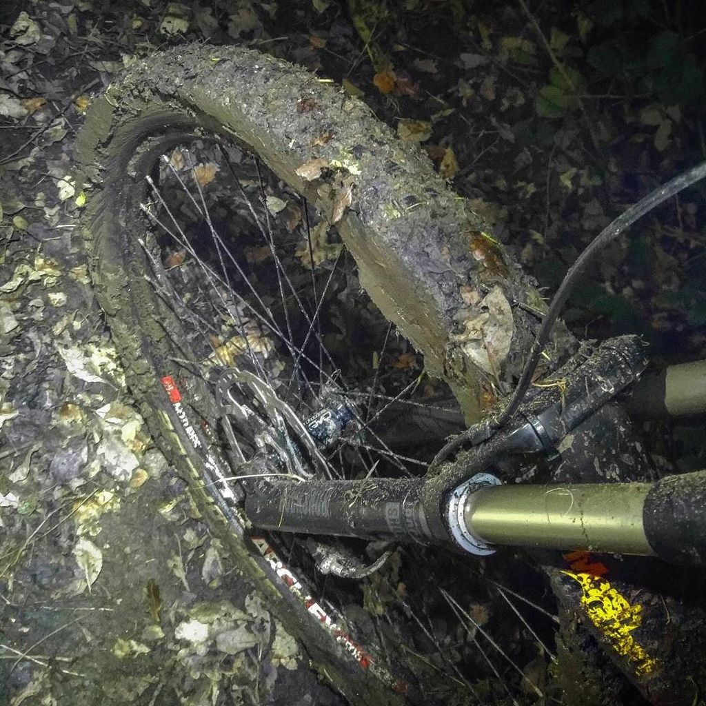

11.5 months a year on the front in the Tweed Valley and a Minion on the back 😆

I can get through a minion on the front in about 9-10 months I think, ordered a shorty, see how it goes, if it dries up and the sun comes out, you can all thanks me 😆
