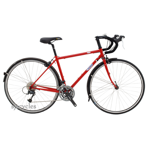

[i]5mm spacer above the stem[/i]
it's to stop the stem bolts crushing the steerer.
Trek void the warranty on their carbon steerer forks if you don't do this.
Thorn don't seem to have got the memo though;
Posted : 10/02/2016 10:08 am
