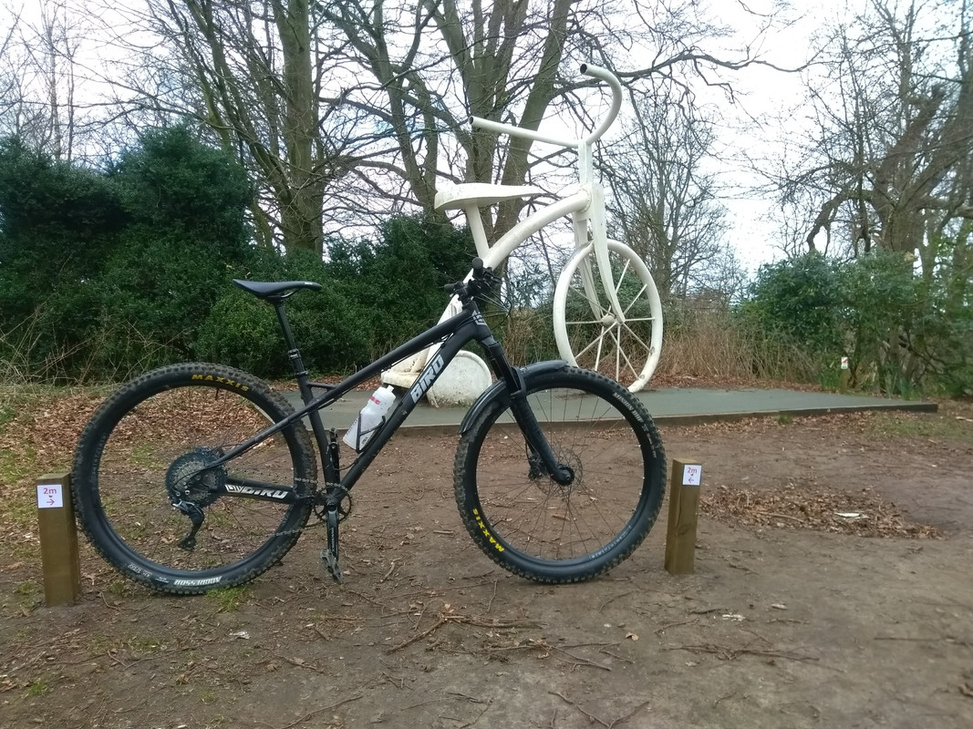

My spesh enduro won't fit through the doors in the house if I roll it through on its back wheel
Maybe 2m?
Posted : 16/05/2020 9:54 pm
Posts: 5661
Yep, take your wheelbase and add 740mm.
Mine's an XXL 29er but has a wheelbase of 1269, so 2m (and 9mm) in length. Looong boy.
Posted : 16/05/2020 11:58 pm
I use an old medium size 29er with 80 mm Rebas and 2.0 tyres as a hack. That's 1800 mm long, with a 1080 mm wheelbase. A modern geometry medium with longer forks and slacker head angle will be much longer than that, so you will need to turn the bars or remove the wheel to fit into a 810 x 1725 shed. Or prop the front wheel up on something.
