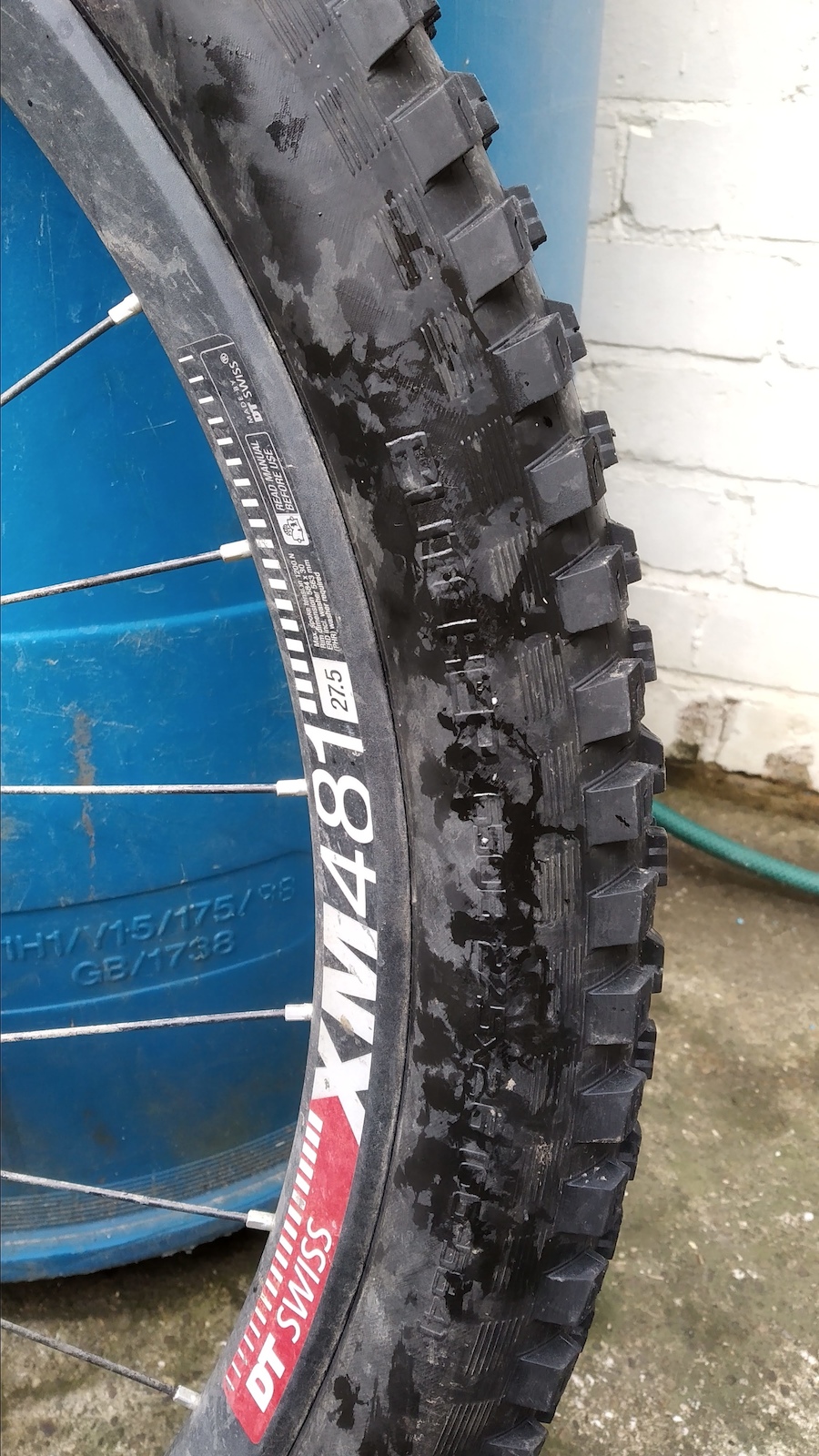

This is a week old Butcher Grid,the Slaughter Grid that it replaced did the same as this.Doesn't cause too much of a problem,except the tyres are oily on the sidewalls and Stans level has to be kept an eye on.
