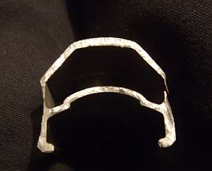

Or cut them in half, an if they look like this, throw them away.
