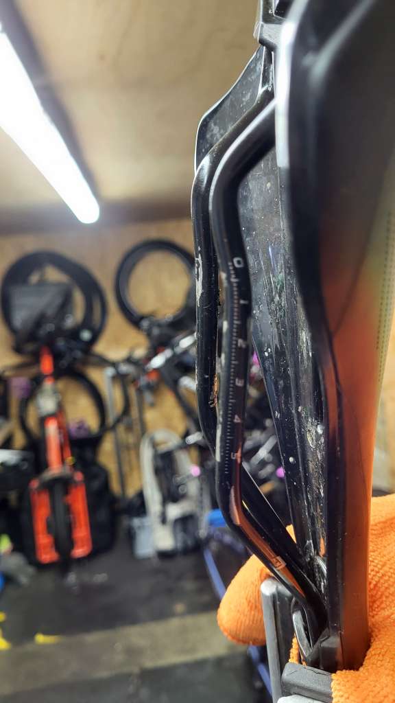

20231212_134126

Posts: 1350
with a puller?
or put a bit of bar with a nut on each end of the rail, then get the mole grips on it at midpoint
Posted : 12/12/2023 1:57 pm
Posts: 167
It's knackered,  lob it. Gone past elastic limit.

Posts: 5153
It’s knackered,  lob it. Gone past elastic limit.
This. It'll just bend again.

Posts: 1103
A bit of kitchen worktop to rest the saddle on rails down, drill two holes side by side staggered in the worktop use two chunky coach bolts M10 or bigger and some washers, one bolt head on the inside of the rail, one on the outside of the rail, as you tighten the bolts down they'll pull the rail flat, I did this years ago with a titanium railed original flite saddle, you might need to fasten down the other rail as well.

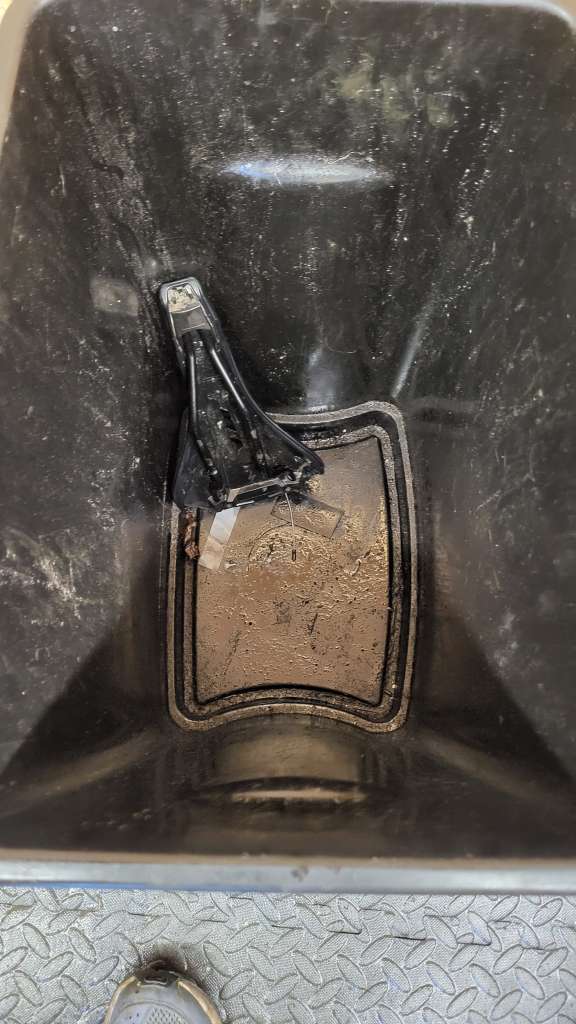

20231212_143005

Bend the other rail to match and the odd angle will be taken up by the seatpost clamp.

Posts: 1103
Did you throw out a baking tray as well or is that the bottom of the bin 😀
Posted : 12/12/2023 3:08 pm
Posts: 2923
Lol bin
