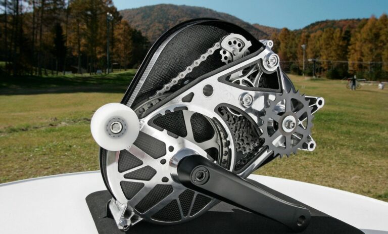

I’m curious what is actually in the bottom bracket area of that demo.

I would guess that in the bottom bracket area of the demo is an enclosed version of what's on the pivot phenix, that's an uneducated guess with nothing to back it up fwiw...
I would further guess that the advantages of the gearbox are real, but in pure performance terms minimal.
maybe more 'feel' than anything else, like, If you put one of the fox factory riders on their rhythm level forks they won't be that much slower...

The Honda bike from 20 years back had a gearbox. Made no difference to the bikes people ride everyday.
It kind of had "gears in a box" as opposed to a gearbox
Posted : 10/06/2025 3:50 pm
Posts: 6980
It also wasn't for sale, so impossible to say if it would've had an impact (it certainly would've been bought by DHers if the price was close enough to the competition)
That wasn't a proper gearbox - hunt down the video of it's internals.
https://www.cyclingabout.com/inside-the-revolutionary-honda-bicycle-gearboxes/

I still think that it makes more sense for gearbox bikes to have the drivetrain fully enclosed. Similar to the Millyard bike. Totally isolate it from mud and debris.
I think gearbox DH bikes make 100% sense a friend has had a Zerode Taniwa for a few years and it’s been faultless.
