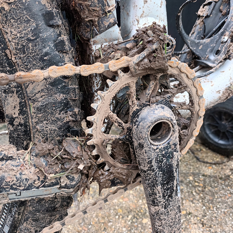

how well does hot wax cope with muddy conditions?
Very well.  It's vastly more durable than drip-on lube, and it's very easy to see why when you look at it.  It's thick as hell and sticky.  I usually go all summer on one application (sometimes with a top up of drip, which seems to rejuvenate the wax), and in the worst conditions I see it lasts several rides.
It's worth noting that in the picture above, the lube hasn't lasted one ride - it's completely gone about 20 minutes in, but it probably wasn't actually protecting the chain at all.  If you listen and feel for grit in the chain when using wet lube it's there from the first big muddy puddle.  With wax though, it lasts several rides without getting gritty even as you plough through puddles.
Posted : 06/05/2024 10:07 am
