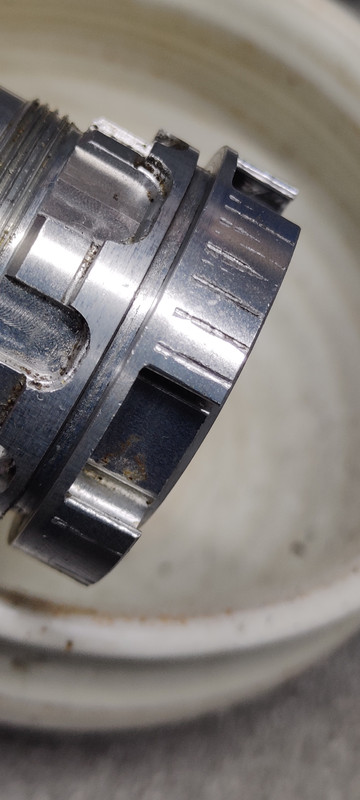

Buddy blew up his Nobl rimmed Pro4 yesterday top of teh climb, furthest point from home of course. It ended up as a fixie.
Damage to the freehub and drive ring is (I assume) terminal but what options are there for replacing the drive/ratchet ring to make it serviceable again?
I guess the exploded pieces of pawls have eaten the ring and taken a few teeth off in the process.

Generally if the ring has been damaged, Hope will fix it under warranty, however often a new set of pawls and springs is all that's needed.

I've stopped using hope hubs. They're not bad and as we all know spares are easily available, but I got fed up with low pick up, average bearing life, persistently annoying leaf spring failures and bendy axles/hub flex resulting in this.

Posts: 11355
I'd seen that on my Hope freehub too, always wondered how it happened! I couldn't honestly believe that the hub would flex enough that the freehub body would make contact with the drive ring?

What other explanation is there?
My Pro2s used to do it a bit, but it was more a cosmetic mark. My Pro 4s were taking gouges out. There was sufficient material displaced that I thought it best practice to take a file and make the free-hub smooth again.
I can see it happening once the drive side bearings blow, but that above picture is from a 4 month old hub.

Posts: 11355
Yeah not disagreeing with you at all, it's just the first time I've seen someone else having experienced the same marks on the freehub body.

Posts: 9046
Ive also seen those marks on the older ti and steel freehubs from ti glide to XC to bulb. Those axles are solid, so are we sure it entirely down to flexing 😕

Posts: 3212
This one also has those same marks on the freehub. Bearings are fine so yep, must be axle flex..

Posts: 665
I've had those marks too - I think they happen after one of the pawl leaf spring breaks, and the free hub gets pulled into the hub body by the chain.
