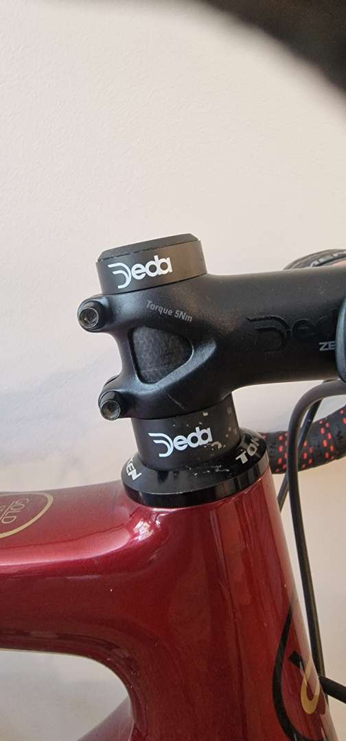

Probably ok....My only concern would be does the bottom of the bung go down into the bottom of the stem clamp? That would be something I'd be unhappy with. Maybe juggle the spacers so not quite so much above the stem. Was running a too short bung in mine and it never quite felt secure.
Now running a 70mm bung w 10mm spacer above and feels totally secure 20250708_110301.jpg
