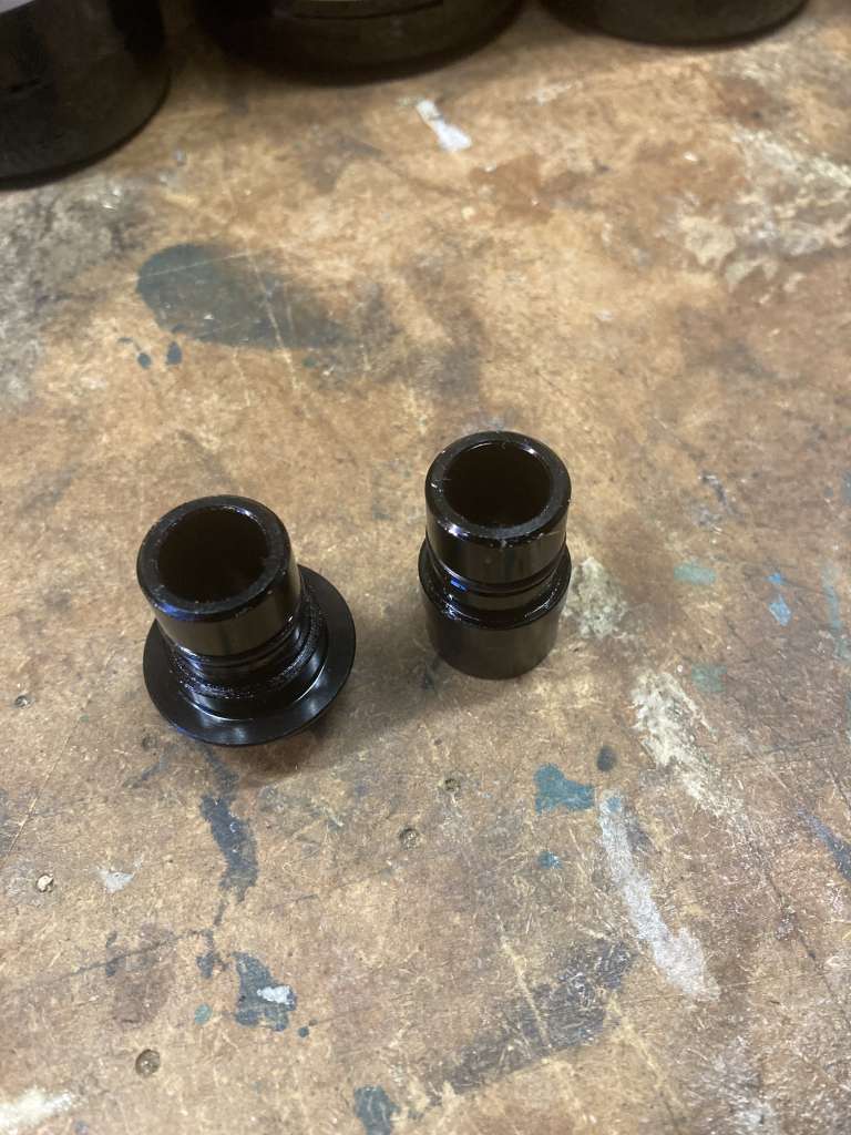

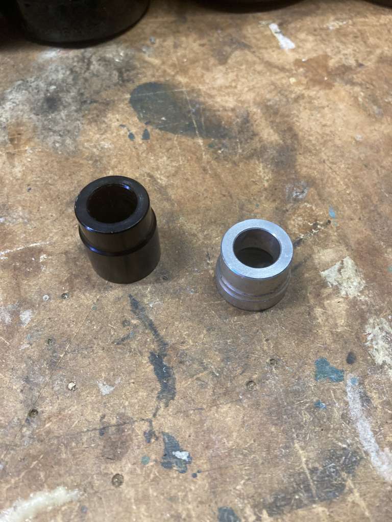

Some photos of the Hope RS4 end caps. <br /><br />Front:
IMG_7540IMG_7541
Rear:
<br />IMG_7542IMG_7543
Sorry to be an arse, but I’ve just been offered a carbon fork for my Genesis CDF, so I’m planning on keeping the axle caps in case I do fit the fork. Sorry.

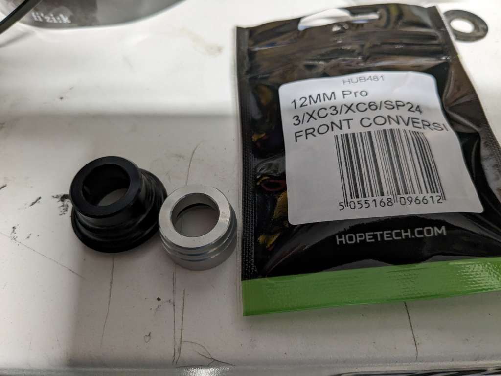

I think I've been sent the wrong parts again - it says front on the packet, I think these are rear.
PXL_20231229_203252420
Posted : 29/12/2023 8:34 pm
Posts: 5626
@jimmy
What hub have you got? Is it RS4 6bolt disc or centre lock disc?
What is in your package looks like a rear to me. I can ask a mate who has an encyclopaedic knowledge of Hope parts if that will help?
Posted : 29/12/2023 10:48 pm
Posts: 8669
@bigblackshed it's an RS4 6 bolt. I agree, I think what I've been sent is a rear kit.
Is yours 6bolt or CL?
Posted : 30/12/2023 9:09 am
Posts: 5626
Mine is centre lock.
The serial numbers on your packet is correct for your hub, or so it seems, but the end caps certainly look like rears to me.
I’ve been through my spares box and all of the end caps I’ve got the rears look like your picture. All of the fronts both sides are black, it’s only the rears that the drive side is silver. None of what I have are the correct ones for your hub I’m afraid.
Posted : 30/12/2023 9:46 am
Posts: 8669
Ok thanks, I've emailed the shop a pic so I can return them hopefully.
