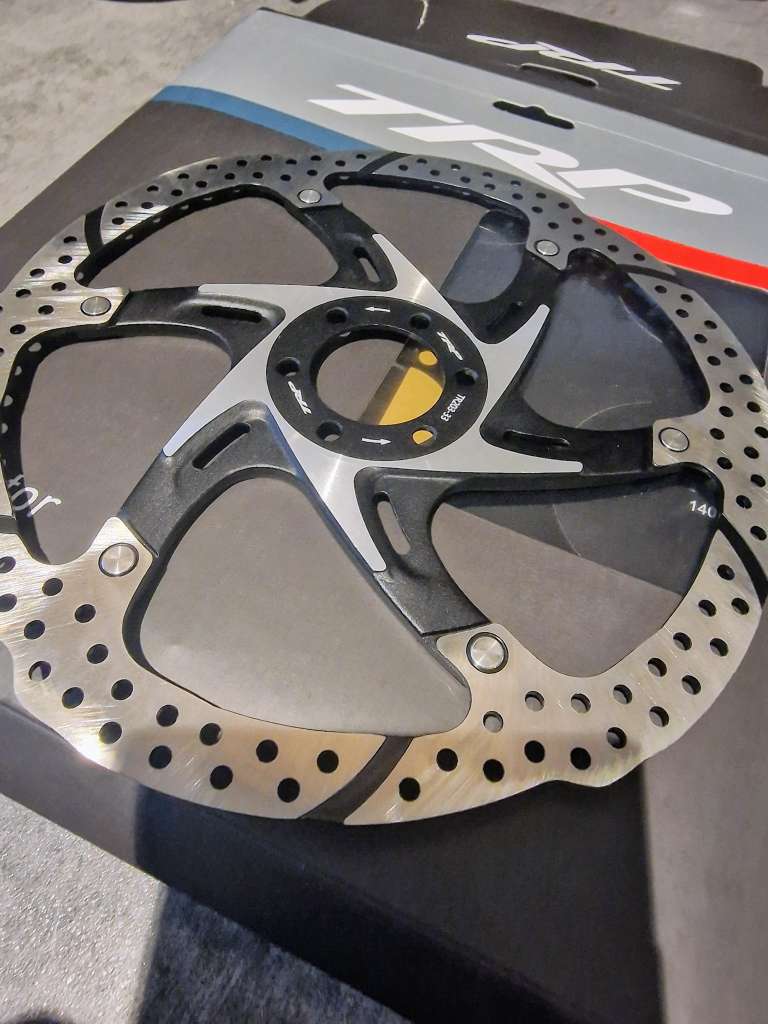

Running these TRP 2.3mm thick rotors on one of my bikes. Not had enough use to say if they are any better than thinner rotors though.
Came in about £90 for 180/200
