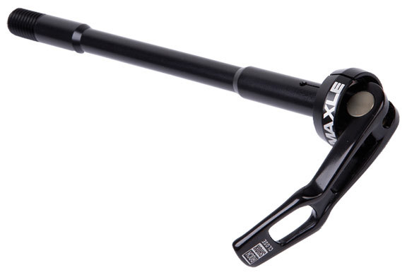

The problem only occurred with the stepped Maxle (see image below). So long as you don't have this the ProII axle is fine.
No new frames should have this stepped Maxle. They were only in production in 2010 and were replaced under warranty for straight ones by SRAM.

Not at all, both that I snapped were with full thickness axles (in a Last Herb and a Dare), pretty commonplace. Hope did replace them quickly, mind, and got bonus comedy points for sending me 2 replacements for "the next time it happens". Sometimes "no questions asked" really just means "no need to ask, we know our product's substandard".
So, I converted to Evo, which is bang on. Not cheap to do but well worth it. This also means I have a couple of spare pro 2 135x12 axles if you'd like to go down the multiple redundancy route 😉
(might be easier and cheaper to find a used Evo hub or wheel and swap parts, then sell on the old bits as a complete hub?)

I've also snapped one with a standard Maxle, although it lasted a lot longer than the previous ones did with the stepped Maxle light. Hope offered free replacement with stronger steel axle upon returning broken one - not got around to sending off the broken one yet (as replaced it with a spare aluminium one) so cannot comment if this solves the problem.

Snapped 4 with a standard Maxle. Avoid, unless you can get hold of a steel one.

Also snapped a pro2 axle with a normal maxle.
Hope gave me the option of a free aluminium or steel replacement. I went for the latter. So far so good.
Only adds a few grams to the weight so thought it better to be safe than sorry.

The issue with the old one is that the maxle diameter is 12mm and the internal diameter of the hub/freehub bearings was 15mm. So 1.5mm of aluminium each side...
I did actually get my old mechanical engineers hat on and do some sums on that, 'cos I was getting frustrated at breaking so many. Lets just say it was no surprise to me that they were snapping...
