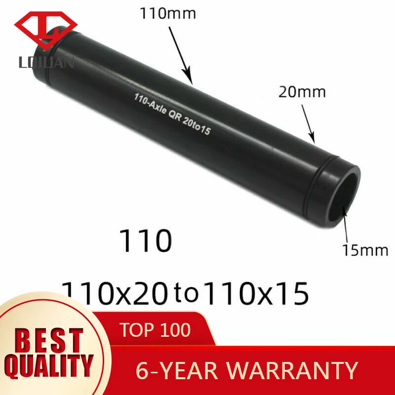

I use one these on a 20mm front wheel to run it on 15mm axle forks.
Works perfect.
https://www.ebay.co.uk/itm/235328600243

@dave_h that’s interesting as it would allow me to run the wheel without a re dish so I could use the original 20mm forks as spares.  How does the 20mm end cap work interfacing with the dropout on a 15mm fork ( unless a RockShox with a torque cap option) - I’m using a Fox 38?

So the 20-15mm converter won't work with my forks, they're machined on the drop outs to accept a 15mm end cap, 20mm is too big.
Fresh bearings, 15mm converters and a redish it is.

So the 20-15mm converter won’t work with my forks
Did you try to fit it?  I've ran the wheel with the adapter in Lyriks and Zebs without any problems whatsoever.
Posted : 28/05/2024 9:47 am
Posts: 3247
Did you try to fit it?  I’ve ran the wheel with the adapter in Lyriks and Zebs without any problems whatsoever.
Yes I did, RS forks have the ability to run the torque caps which are bigger so have more space in the dropout (my previous Zebs came with little screw on plates to run standard 15mm), the Fox forks don't.
