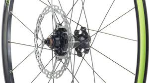

Blast from the past but mrs t-r has a set of these on her bike.
I noticed last night the rotors are past it. ..... Given they are 10+ year old I'm.not surprised.
I cannot find information on a replacement.
Were these made to the Cannondale coda specification which seems easy to find - or did hope make a new standard...... I can find the xc sp3 rotors for my bike easy enough but that's a hope only thing by now - (barring the old rock shok disk set up of 1998 using 3 bolt)
The tech manual for the wheels doesn't help for disks.
https://encrypted-tbn0.gstatic.com/images?q=tbn:ANd9GcT1ne5fg7etj3DQfy_a72PvUVazSDVlII9TZQ&s
https://www.hopetech.com/product-documents/wheels/#!pro-3-mono-sp-front-hub-exploded-view

Your best bet is almost certainly going to be too talk to hope.

I think I've got one, but can't check until Monday.

Hope certainly used to do 160mm and 180mm discs for them.  I probably have a couple of 160mm going spare maybe a 180mm, I can check later and happy to stick them in the post if they are in OK condition
Ah, that is what I have.  Are the AM4 different?

I’m sure hope will be able to run you off a couple of you ask nicely.
Failing that - if they’re the 4 bolt ones, I think I’ve got at least one spare in the bits box.

Will speak to hope on Monday but it's the weekend thought brains trust might know.
Yeah am4 are 4 bolt the xc3 are 3 bolt.
It's 160s I'm needing. If anyone does have spares I'll gladly purchase them.
Xc3s still seems readily available so I'm albut convinced the 4 bolt are the easy available from hope coda standard. - I don't see any other  reason hope would make coda disks easily available still.
Will confirm with hope Monday.

For anyone looking in future.
Coda 4bolt is ~38mm
Rohloff 4 bolt is 52mm
Am4 4 bolt is 80mm.
Annoyingly almost  anywhere that sells a 4 bolt coda or rohloff uses the am4 picture

I have got one but it's 203mm
