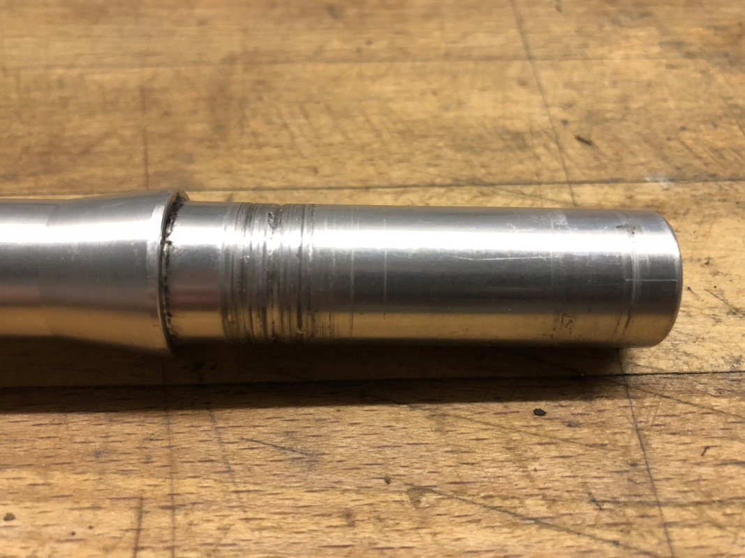

I'm having a really unsatisfactory time with my Fatsno Pro 4 rear hub. The inside free hub bearing is shitting itself very 2-4 months. This is a relatively easy fix if at home but when it goes, it's a ride ending event. I'm riding about 60 miles a week, mostly off-road, and I am a huge fat bloke. It's on a hardtail. It's a 29+ wheel if that makes any difference.
I am going to check more frequently how its doing, and I ordered a few replacements for just that one bearing so have some stock.
But really, this is not great.
Thing is, on my older fat bike, it's run a pro 2 Evo for about 6 yrs with me doing absolutely nothing do it. On of my riding buddies has borrowed that bike for the winter and in doing a spring clean we replaced all the bearings, and sure they were maybe a tad off perfect, but nothing like grinding themselves into cubes.
So, any thoughts on what the 'f' is going wrong with my Pro 4?
It's only the inside free hub bearing, never any others. Thus far, when it goes It's been changed by me, my local shop, Bike Works in Edinburgh... and so far we've changed all 4 bearings each time. Expensive, and we can't all have done something wrong so fitting is not the issue.

Based on comments above, I suspect 2 things:
1) Perhaps this axle was made slightly out of tolerance
2) Every time the bearing goes, and there have been 2 occasions when the bearing completed disintegrated, its grinding material from the axle
For sure, when it went at the far end of the Pentlands at Christmas the mush of broken bits gouged some pretty big scores in the axle.
Time for a new axle methinks, I am too damn invested in spares and tools for the Pro 4 to go for anything else!

Thought I'd post a wee update in case anyone finds this and has similar issues. Had a chat with my LBS, and Hope, so in the end I did 2 things for my 3yr old Pro4:
1) Now use Chromium bearings for the inside freehub, rather than stainless https://www.kineticbikebearings.com/chromium-144
2) Replaced the old axle (in the piccy you can see the gouging caused by repeated bearing failures - surely this created a vicious circle)
Since all that done, been for plenty local loops and a couple of big days out. Conclusions:
Bike is now silent - interestingly (for me!), before the new axle, even with a new bearing there was always clicking and creaking. got especially bad when you were really grinding up a steep hill. I've been chasing this noise around the bike for months. Turns out there must have been play around the axle, as the new axle and bearing have removed the noise, so far.
Also, so far no big failure. in the middle of a big ride, when hitting a low cadence, techy ascent, that was the exact time when 'crunch!' something would give way. Seems, touch wood, to be OK now.
Which is exactly what one of my Pro 2 Evo rear hubs did. Taking the axle with it. To be fair to Hope, they replaced the parts FOC after I sent them the shrapnel and axle for inspection.
Posted : 18/05/2020 9:38 am
Posts: 3508
100% the axle was the issue here. I found that once a bearing has shirt itself and the axle was marked/scored it was just a case f time before the next new shiny bearing went the same way.
Like BWD, I called hope and asked about bearing failure and longevity. After sending in all the bits I got back replacements.
