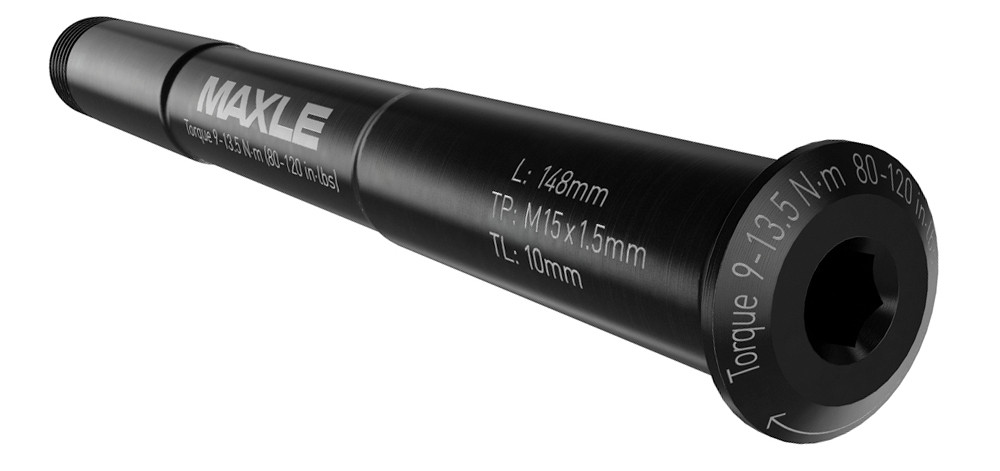

Does anyone know a source for a decent 9mm thru axle or even a bolted axle - would be ideal to have a RS type Maxle Stealth non QR axle but with a 6mm allen ket 'nut' on the end.
I know SS used to make a 9mm QR some years back - prefer a DT type but even better if it combined the allen key Maxle Lite with a nutted end.
So ideally this (in 9mm) with a nut for the end:
