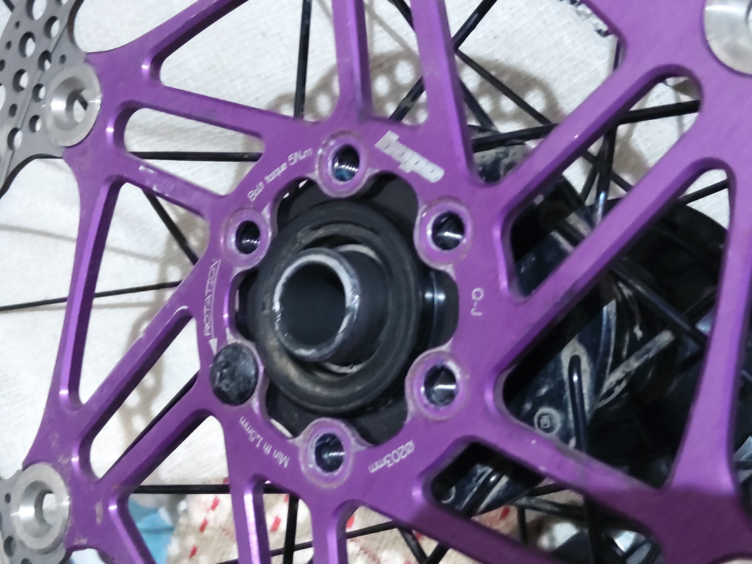

OK this is the front wheel in the forks ...as you can see it's off centre by 7/8mm
I'm thinking I need HUB480

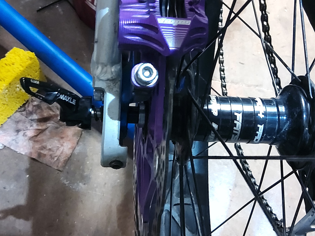

The rear wheel looks like this
I know I only have one bolt on the disc...its just temporary..lol
Do the adaptors also double up as dust seals?

https://i.postimg.cc/zfGt4ZCT/20211002-232025.jp g" alt="front wheel off centre" />https://i.postimg.cc/ydFZPWDj/20211002-232116.jp g" alt="rear wheel" />https://i.postimg.cc/CMnF99Jy/20211002-232248.jp g" alt="rear wheel Close up" />
