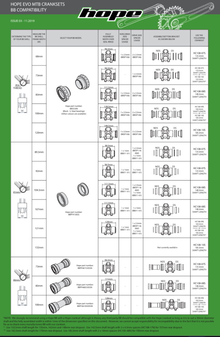

Looking to get some Hope Cranks for my 2022 Nukeproof Mega 290 Carbon - 73mm BB shell and 52mm chain line.
I "think" in understand the options.
I can either go for the Hope Evo 68/73mm crank with a boost chain ring, or the Hope Evo 73mm crank with a non-boost chain ring.
Am I right?
Any reason to choose one set up over the other?

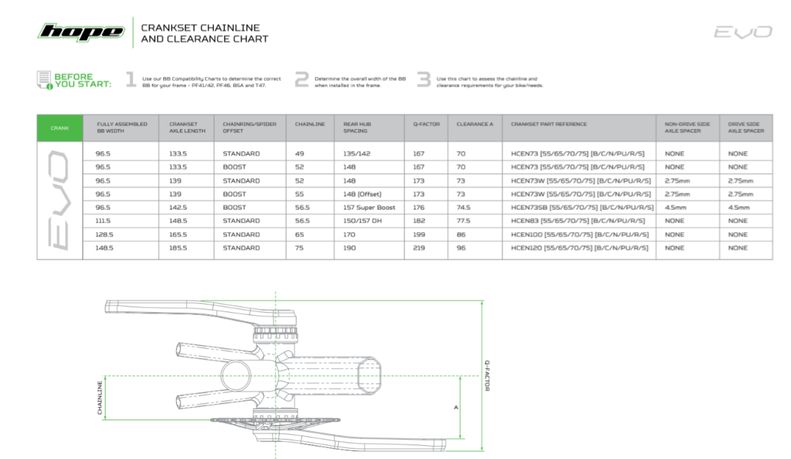

I'm looking to fit a Hope evo crank on a bike that currently uses a 52mm chainline but may at some point require a 55mm chainline.
I too interpreted the Hope PDF on this that I could achieve this with a 73 Wide crank using a standard ring for 52mm or Boost ring for 55mm. But it'd be nice to be sure it'll work.

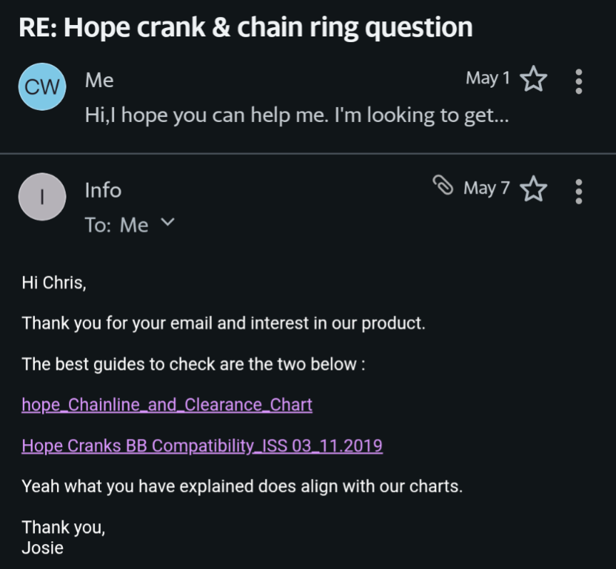

I emailed Hope and got the following back:
Not sure if that clears it up to be honest....
Posted : 16/06/2025 6:42 pm

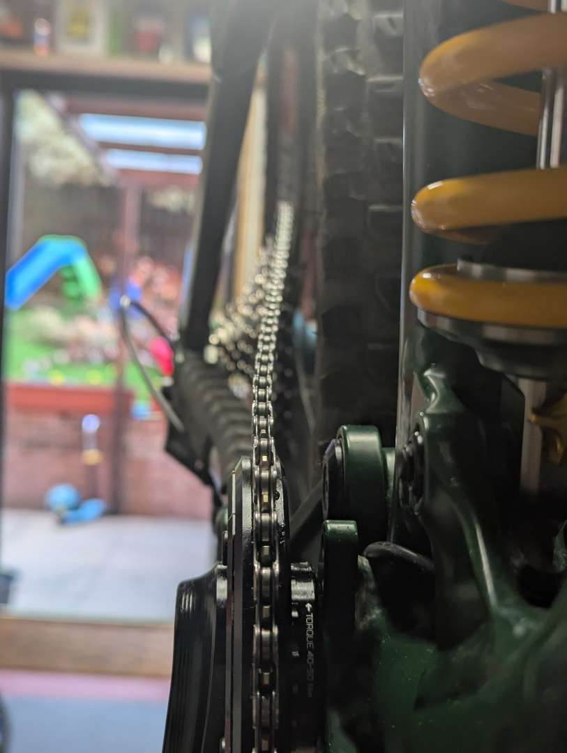

I've been struggling with chain line since fitting a Hope crank and BB. They haven't been very helpful to be honest. I managed a couple of single sentence responses. They didn't even send me the links posted above.
Matt from Rimpact has been pretty helpful but we still haven't figured this out. He's says the Rimpact chain damper should give me a chainline of just over 51mm but for some reason it's sitting way further outboard than my Shimano did at 52mm
I haven't had time to mess with it this week yet but I'd like to sort it out so I can ride it.
As you can imagine this is pretty rumbly in the larger sprockets.

Posted by: dirkpitt74
Yeah I've already looked at those.

Just spoken to Hope.
My reading of the PDF was correct.
73 Wide crank with a standard chainring will give a 52mm chainline.
73 Wide crank with a Boost chainring will give a 55mm chainline.
68/73 crank with a Boost chainring will give a 52mm chainline.
So for my application it will be a 73 wide with standard chainring, then switch to a boost chainring if it gets T type fitted at a later date.
