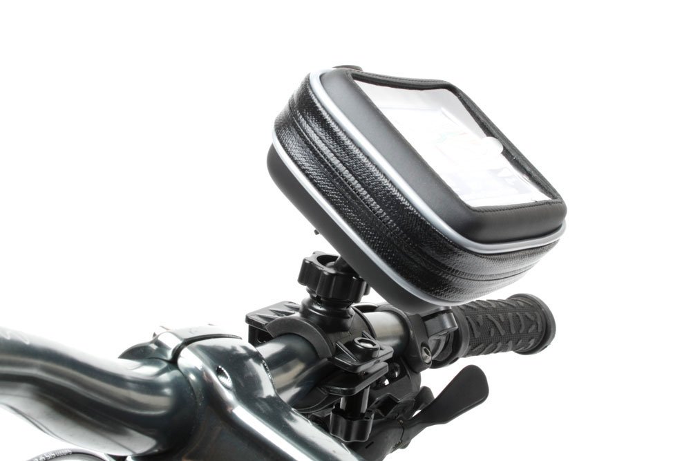

So, if you are looking for a secure way to mount your smartphone, have a look at Edinburgh Bicycle Co-operative
Revolution Smartphone Holder
Click to enlarge
(6 reviews)
Free collect
in store >
Exclusive >
Find out more >
Handlebar stem-mount Smartphone holder.
Makes your phone accessible when you ride.
Especially useful if you use your phone as a GPS.

weordie
Newcastle
Great little smartphone holder. Easy to attatch to the bike as well. Emphasis should be on little though, won't hold a phone like a Galaxy S4 in a secure way (the top doesn't close over). If you have a smaller phone though it'll be great. Should say in description it won't fit newest models though.
duckwaj
East Sussex
What at bargain! easy to fit, works great and pleasantly understated. Rivals start at about £50. Buy it, its a no-brainer
Matt W
Warwickshire
A great idea in theory and having had a bad experience with a less than solidly attached phone holder, this looked ideal. The construction is solid however Edinburgh Bicycle need to point out that this is not suitable for angled stems as the mount does not sit correctly on the headset. I do feel that I have been misled into thinking this product would work on my bike.
