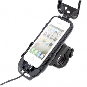

Might as well post my own solution here for anyone that is interested:
Ultimate Mobiles case (waterproof and fairly bash proof):
http://www.amazon.co.uk/dp/B0057FJ41Y
[i]Customised[/i] with some Araldite to remove the rotation option (I never need landscape) and the rattly quick-release option. 🙂

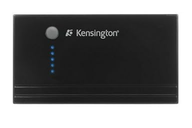

For long rides (4hr+) where phone battery life might become an issue then I have a very short (20cm) right-angled USB lead (from ebay) that runs from the case:
to a top-tube mounted tri bag:
[img] ?w=350&h=350&a=7[/img]
http://www.wiggle.co.uk/topeak-tri-bag-with-rain-cover/
which holds an external battery pack like this in the side pocket:

Bit chuncky Graham but looks good otherwise.

Yeah the case/mount isn't perfect. It was secure, but a bit too wobbly before I Araldited it. And the clamp is too small for road bars so needed 'modified' too.
But it does hold the phone in a nice silicon cushion, all the physical buttons and ports are still accessible, and it is waterproof enough that I use it in the pouring rain without any concern (less of an issue for the Defy users obviously).
