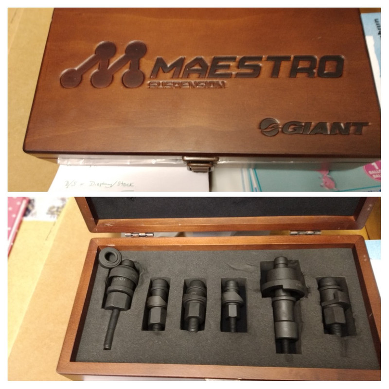

Shed pron has arrived.

At that price I'm not actually going to use them!
Posted : 03/09/2019 11:36 am
Posts: 4439
thats a nice set, how much was it?
why dont al bike manufacturers do this? Im concerned about tools on carbon frames.

I have the maestro set-was a good investment for when I had an older 2010 Anthem and 2006 Reign-made the job an easy joy to do especially as some of the bearings are recessed from what I recall. I think I paid around £90 for it back then.Do giant still do the kits for working on their newer bikes
Posted : 03/09/2019 6:00 pm
I paid £79 and I had the bearings swapped in under 30 minutes.
A beautiful job to do , my bike no longer creaks and rides like a dream. A brilliant investment.

Tools from cycle store and bearings from kinetic..
The old bearings just popped out and the new ones went in without the merest hint of being on the skew.
My new favourite job.
Posted : 04/09/2019 9:02 am
I just bought this to go with the bearing puller spacers kit jobbie.
I assume it fits through the holes 🙂
Posted : 04/09/2019 9:03 am
