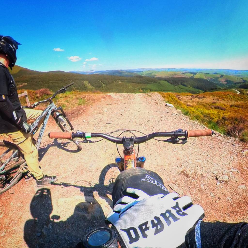

@weeksy
38mm risers on mine. Bloody lovely.

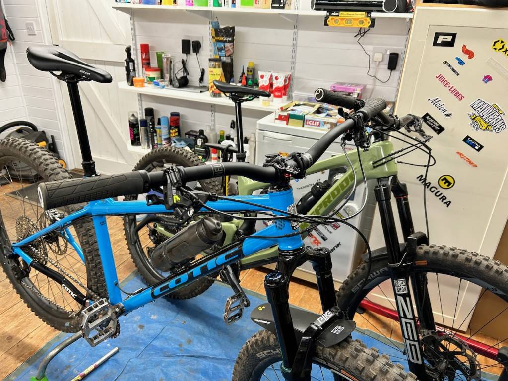

 Alex
Posts: 7447
IMG_0571I run 38mm risers on my BFEMax. Defo found the front end to low on that. Other bikes still run 20mm but with some spacers below the stem.
