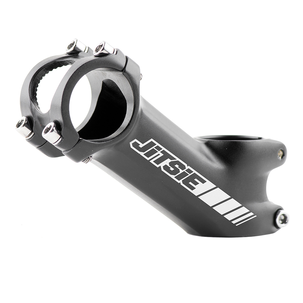

Posts: 1819
No, but I use a positive rise stem to accomplish the same thing. Much cheaper and easier than a new set of bar and messing about with new bar tape.

Just. Flip. Your. Stem. Pretty common on track bikes these days, including one of mine. And add shallow drop bars if you must

Cinelli Pista track stem comes in lengths up to 120 mm. That'll give you some serious rise whilst retaining reach. My spare track bike has a classic sprinter drop bar of 11 cm reach and 17 cm drop (yes that much) so I had to flip the stem to be able to reach the drops! The Pista stem has even more angle than typical so is a nice cheap option before going down the route of new bars. There are some cheap adjustable long stems too on Amazon for about the same price, but they are very flexy and I would not ride one off road.
https://www.chickencyclekit.co.uk/shop/stems/cinelli-pista-stem/

I kid you not. I've got this bad boy on my gravel bike 😂

595mm of stack on xl gravel frame is rubbish. Well it wouldn’t fit me. On my Arkose I’ve got the stock 90mm stem flipped and loads of spacers. The Arkose has 632mm of stack.  I have so many spacers it’s a steel not carbon fork.
The Rambler has a 70mm 35 degree stem. I don’t think it’d want a stem that short on the Arkose. The steering would be too far for me
A steerer extender is another option. Before i bought red shift bars I’d check Rob Hayles can’t extend the steerer for less
https://www.bikeparts.co.uk/products/bbb-bhp-22-tubeextend-steerer-extender-28-6mm-black?currency=GBP&variant=43186498044061&utm_source=google&utm_medium=cpc&utm_campaign=Google%20Shopping&stkn=a894e8283159&gad_source=1&gad_campaignid=17176658334&gclid=CjwKCAjw3_PCBhA2EiwAkH_j4lxKbHU5VTOu93cEv1WRWeDnI5Dff7bNoXLdXSoBrXVQ1pCv8ktlHxoCgyIQAvD_BwE
