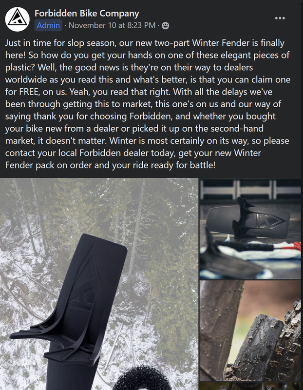

be aware of the Forbidden crush zone requiring all sorts of bodges to stop damage to seat post and swing arm.

A bodge is available, you'll have to import it though
https://jankcomponents.com/products/jank-moto-foam-kit-for-forbidden-druid-dreadnought

think you can get from forbidden for free now, despite them saying there was no issue when riders were complaining of damage  🤔
Posted : 02/12/2021 4:25 pm
I suppose thats kinda good..... in the same way they changed their minds about warrantying frames where the loose shock bolt had led to damage. Not sure i'd be willing to send Forbidden my money over the likes of Deviate or Norco (never thought I'd see myself write that)
Posted : 02/12/2021 4:30 pm
Not really a 'bodge' but Jank were selling something which made it a non issue & now Forbidden are offering a free bigger guard, with an extension to make it a non issue. I at the time did something similar & it's been a non issue. Never had any bolt related issues, and I checked it when I built it up, and do fairly regularly anyway.

Not really a ‘bodge’
yes it is owners were doing this with moto foam and aquarium foam to prevent frame damage  and forbidden refused to accept there was and issue with debris getting trapped and damaging frame.
Posted : 02/12/2021 6:24 pm
