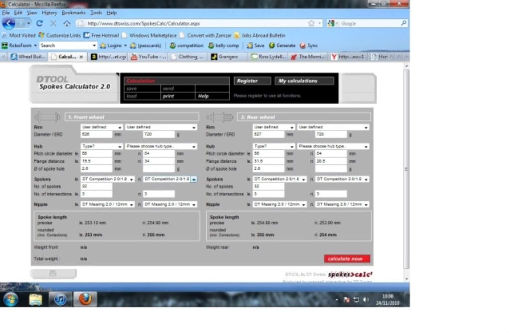

Trying to work out what spokes I need for building my wheels
Hope Pro 2 hubs
Spank Stiffy rims, 526mm ERD, 720 g
does this look right?

http://www.wheelpro.co.uk/spokecalc/
front with 3x
left 243.3
right 254.7
rear with 3x
left 254.1
right 253.3
seems the same as long as you rim measurement is correct - best to get the rim and actually measure for yourself... to double check

thats not right.243 should be 253?
Posted : 24/11/2010 10:57 am
where do you measure the ERD from?
Posted : 24/11/2010 11:06 am
Posts: 41395
From nipple-bed to opposing nipple bed.
Posted : 24/11/2010 11:14 am
this is what its giving me for the front
and this for the rear
Posted : 24/11/2010 11:31 am
So is this what to go with?
Front 253, 255
Rear 255, 254
I see that CRC only sell even sizes, so do you round up or down?
Also what spokes to buy?
DT Swiss comp?
Posted : 24/11/2010 1:48 pm
Think I've got it sorted
256-254mm for both wheels
DT Swiss champion or comp?
Posted : 24/11/2010 6:54 pm
