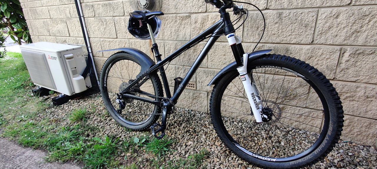

I got one of these for my son when he was 9 and it's been great. https://www.chainreactioncycles.com/brand-x-ht-01-hardtail-mtb-frame-27-5-2019/rp-prod130452
-2 degree headset, Fox 120 mm 650b fork, 26" wheels and a 150mm crank and it's perfect.

[url= https://i.postimg.cc/t4yxjrdv/IMG-20210117-122241-2.jp g" target="_blank">https://i.postimg.cc/t4yxjrdv/IMG-20210117-122241-2.jp g"/> [/img][/url]
Managed to fit a 120mm One up dropper too after a bit of drilling and filing.

Just finished building my 8yr old's 26er. Will post a new thread for it. Had massive budget creep. It started out as a totally stock new Voodoo Nzumbi 13" from Halfrauds and ended up something quite different including new paint, RS Reba's, Deore brakes, Zee group, new superstar wide rim wheels Renthal bars, Thomsen stem and so on.
He absolutely loves it and flies on it. Saddle is pretty much towards the bottom right now, and he is running 152mm cranks and a 100m airshaft in the Reba's (which are 27.5 forks). I have a 120mm air shaft to go in once he is ready for it.
Looks properly pimp in Audi Nardo Grey with new blue graphics (very different to the original fluro orange).
