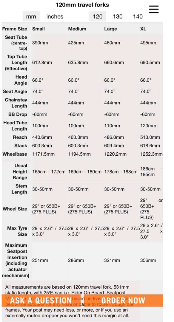

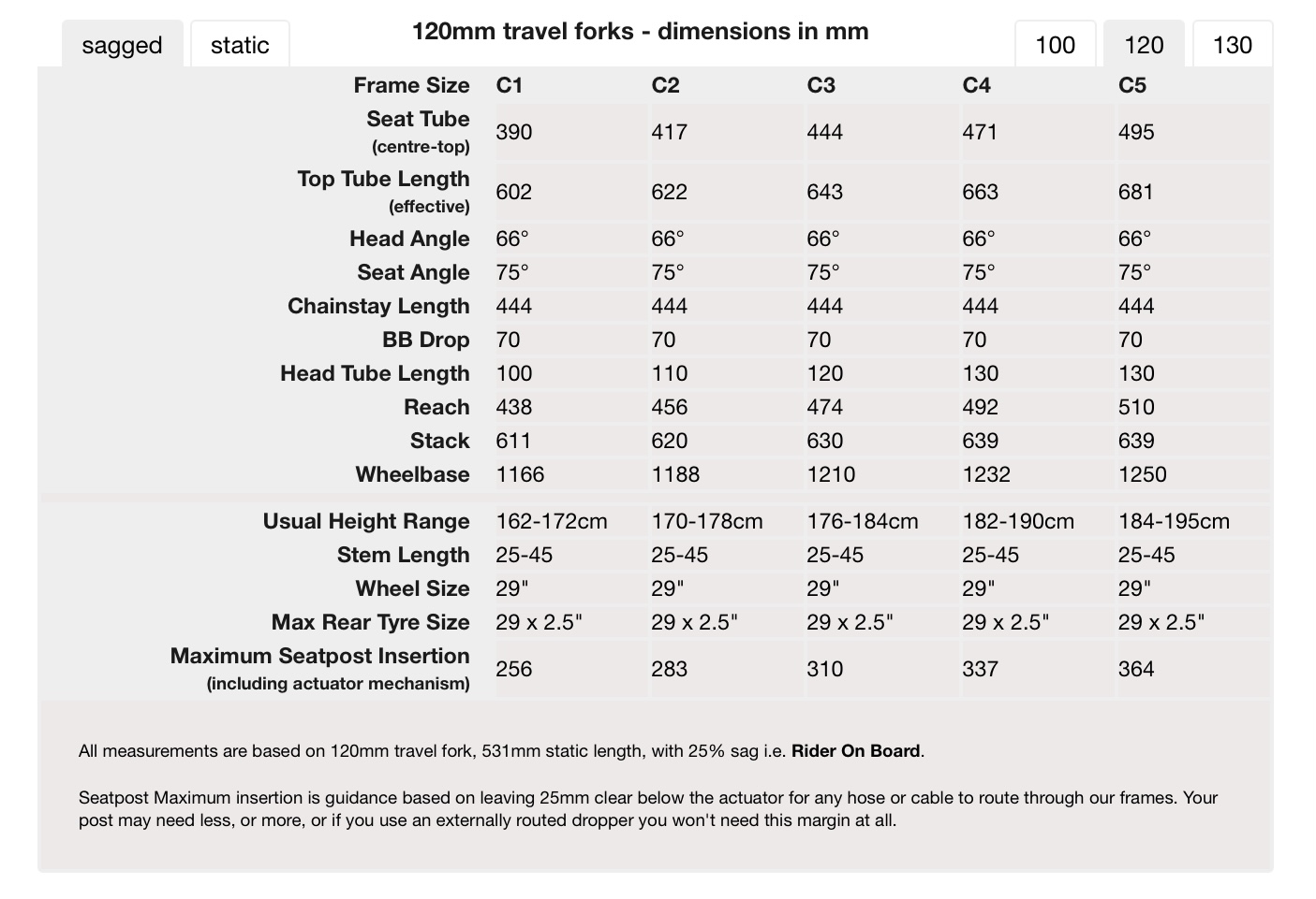

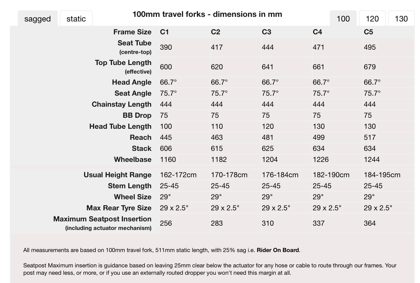

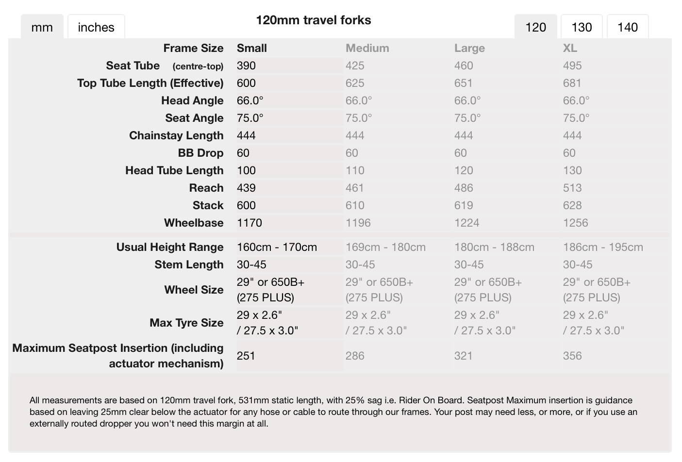

To my simple, untrained eye the geometry of the current Solaris and the last Solaris Max frame are very similar for a sagged 120mm fork.
The first table is the last gen Solaris the second the current:
The current version is advertised as being able to run a 100mm fork but the previous version is advised as needing a 120mm minimum.
Based on the above I can see no reason as to why the previous version wouldn’t work* with a 100mm fork.
What am I missing about why makes the latest version different?
All help in addressing my confusion would be very welcomed.
*I appreciate you could stick a 100mm fork on the previous generation and you don’t need a table to tell you that but I am curious as to what I’m missing as to why it might not be recommended

Stack is a 11mm higher on current version? So longer fork would increase that even more. But i still think thats no reason to not put a 120 fork on it. Plus thats the cotic table isnt it? In which case they also think 120 or even 130 works fine.
But as an owner of a number of cotics my answer would simply be to ask them directly.

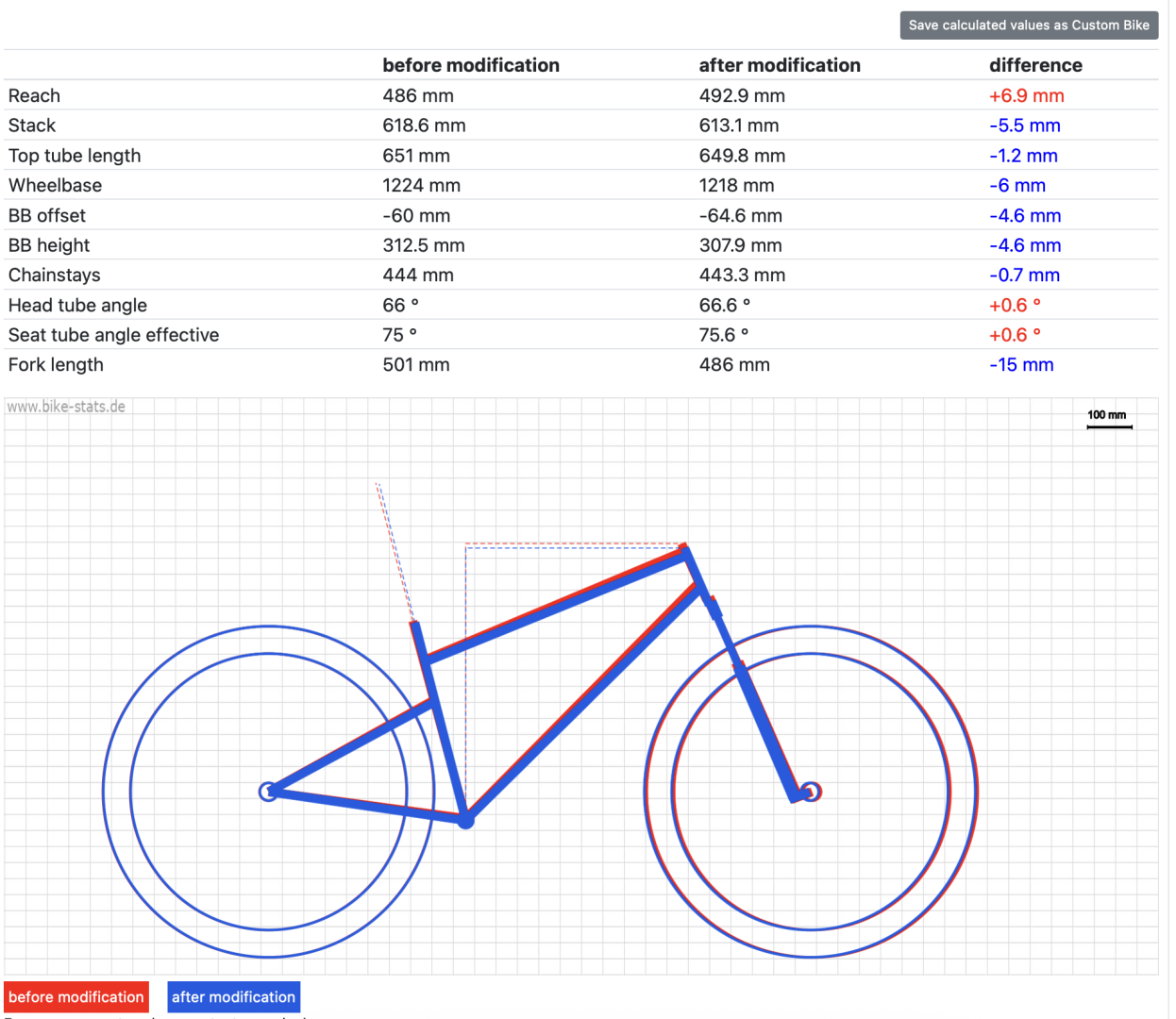

I just chucked that into the calculator on www.bike-stats.de, using an assumption of a 100mm fork being 511 a-c unsagged, and 486 a-c sagged 25%. This is large frame, 2021 Solaris MAX. Can't imagine that being a problem...

Posted : 10/09/2025 11:34 am

Looking at the Cotic geometry table for the current model with a 100mm fork the figures look remarkedly similar (which was my hope):
Posted : 10/09/2025 11:42 am
Posts: 4858
If I understand it ( which of course I may not! ) the BB on the newest model would be 10mm lower than the earlier version with a 100mm fork.

My first thought was 'will the BB be too low?' but the chart suggests the current model has a 10mm lower BB. Whatever the reason was for not recommending a 100mm fork previously, I suspect opinions at Cotic have moved on

This is the geometry chart for mine:
The seat angle is not as steep but the BB drop is the same.
So I’m guessing that a steeper ST may be moar betterer but the HT is shorter reducing stack … further reduced (compared with the 2023 model) due to a shorter (10mm) HT.
Posted : 10/09/2025 1:26 pm

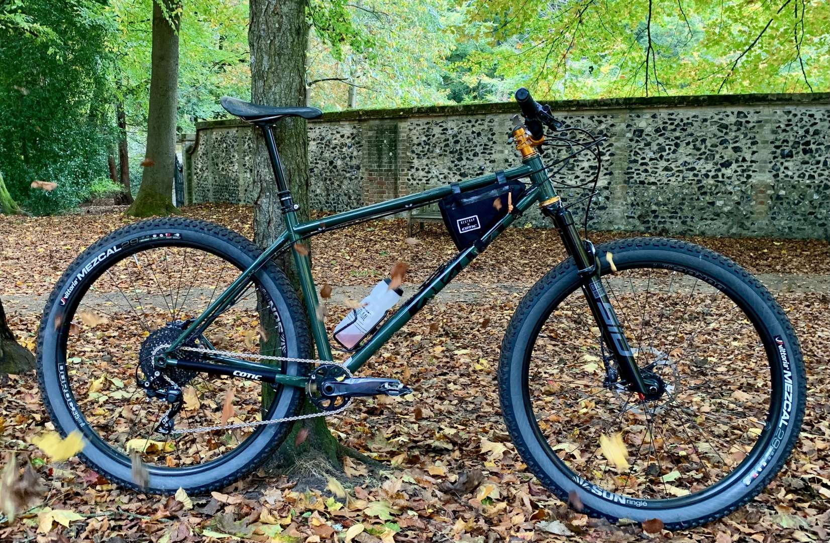

Anyhoo a photo (as that’s what you really want):
Posted : 27/10/2025 10:37 am
Posts: 4858
 IMG_3865.jpeg Or not …
Posted : 27/10/2025 10:40 am

I think I have that same SID in 120mm travel on my Ritchey Hardtail if it's the 'Select' model? I rarely use more than half travel, it sits nice and high but just takes the edge off everything in normal trail/bridleway riding but with some in reserve. I like that the lockout still has a smidge of travel/give so even locked out it doesn't get knocked off line too easily.
The bike looks great too 👍
Posted : 27/10/2025 12:14 pm

Sweet ride 👍

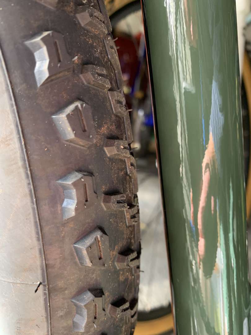

What size are those tyres though? Rear looks very close to the seat tube.
Posted : 28/10/2025 9:49 am
Posts: 4858
They are 2.6” tyres on 35(?)mm rims.
The photo makes it look a lot tighter than it actually is.
Maybe 12-15mm
