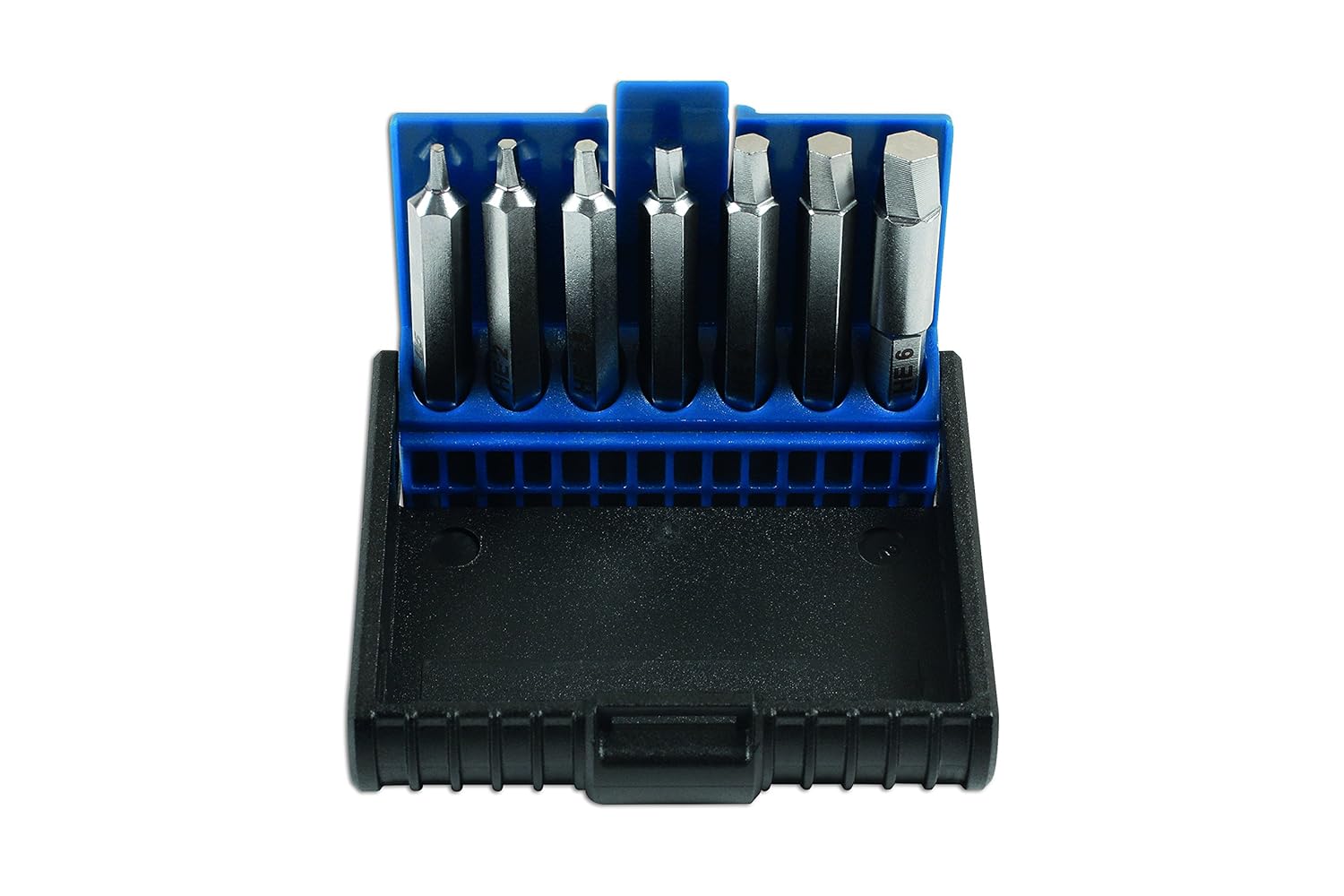

https://www.amazon.co.uk/Laser-Tools-6844-Damaged-Extractor/dp/B071LGWQ8Z
Far better than the screw extractors above IMO.
