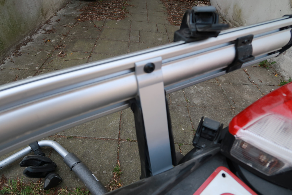

Posts: 10315
Ok, fired the 4th rail on.  It's tight but there might be a slight bit of play on the left hand side and nothing on the right.  No way is it moving from side to side.  Both knobs are hand tight rather than finger tight.
1.  A bit out of focus on the key part but the 4th rail grips quite snugly.  There is a bit of space at some points rather than being an exact fit
2. To show you the spacing.  By loosening the bolt at the rail side (next pic) you can spread the arms apart so that they sit properly on the 3rd rail.  Otherwise you can have difficulty getting them to fit
3. That's one of the bolts to loosen to move the arms apart
4. If you haven't done so already it's worth sticking some foam around the upright so save you chipping the paint on the boot if you forget to lower the bikes before opening it.  That has happened more often than I am happy with myself about
Posted : 01/04/2019 3:45 pm

Hi there really appreciate the help, moved the supports wide like your picture, and also twisted them slightly by loosing on the 4th rail. Now seems much more secure but I’ve still had to crank the handle up as tight as I can and there is still a small amount of play on the right support. The setup is definitely wider than the instructions stated, and done up much tighter than spec. I’m half tempted to call Thule as I’m still not completely happy with it, and now I have a nicely scratched up rack trying to get the bloody thing to tighten properly. I,m looking to carry a weeho which weighs 14kg so I’m possibly being a bit paranoid about the fitting but I was expecting more from a premium product from Thule,
Posted : 01/04/2019 6:46 pm

Well its definitely more secure now the arms are spaced wider, the profile of the rail changes as it gets wider, it flattens out so the clamps can get better purchase than the narrower position the manual states...
Going to drop thule a mail just to check I'm covered for warranty if I use it in the wider position - if not I'll be asking for a replacement
