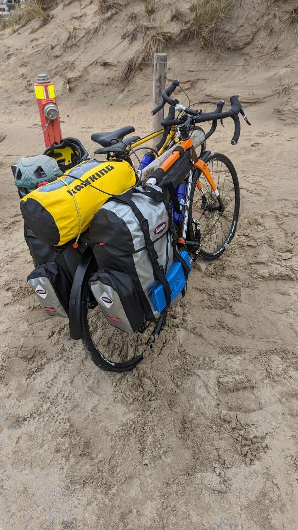

For example I have a big pair of Carradry 24l panniers that need very rearward positioning to miss my size 11s on a medium Free Ranger.  They are, however, a very big and deep bag.
I have a Tortec rack that bolts to seat stay mounts.  It's easy to fit and remove.
If you put all your weight on the back it will make the front feel very light and it will feel unwieldy when pushing the bike and getting on.  That might be exacerbated on a short back end on a small frame.
If you can I'd still put some load up front (bar roll or some low riders).  It will improve stability.
For the top of the rack I've generally used a large dry bag and a bungee.  This is from Holland a year or so back.  A week of clothes, cooking and sleeping gear for me and my son in April (so lots of layers/warm stuff for evenings) PXL_20240401_101813418.jpg

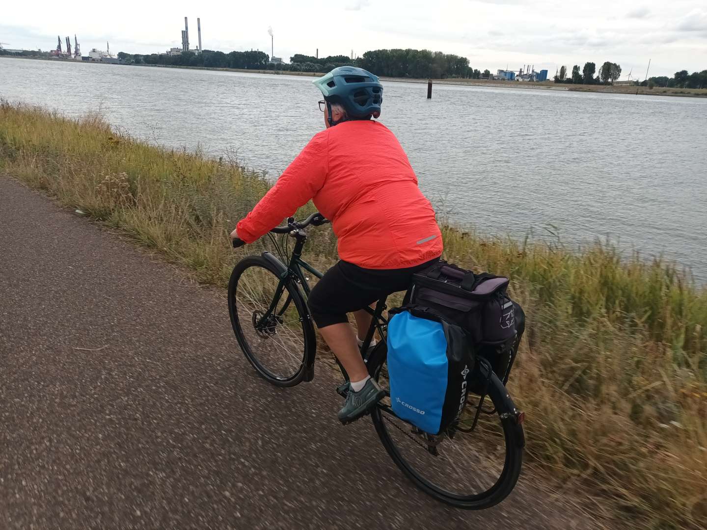

 20250822_181424.jpg 30+ years cycle touring for me and almost has long riding offroad with camping gear for polaris and such.
always used a rear rack and panniers, even on polaris. tent on rack, light stuff in a rucksack.
for the last 10 years we have used Crosso dry panniers 30ltr per side. but now we follow a take less stuff approach and now use smaller 20ltr per side.
as good as ortlieb and vaude, but far cheaper.  from Poland.
seen recently in Holland
