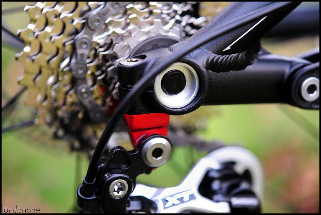

right , the maxle is stuck inside my frame , when I try to unscrew ,the cam and quick release detach themselves from the maxle and that part is stuck inside my frame. the little red bolt inside the quick release has snapped so not sure if that's causing the problem, any ideas ?

I'm a bit confused, is it a Maxle axle or X-12 axle? they are different. Are you sure someone hasn't been buggering about with it?, i.e. putting a Maxle axle into a X-12 design frame. X-12 is just a simple screw in DT Swiss axle on my Cube Stereo, Maxle (on my Bro-in-laws bike) is a slightly different design, a sort of similar screw in axle affair, but with a more complicated camming device. Have you bought it 2nd hand off classifieds/ebay or was it yours from new?

So, am I right in thinking, the QR handle is unscrewing from the shaft of the axle, leaving the axle still screwed into the frame?
The only thing I can see, the red button^ takes a 5mm allan key, maybe try sticking a 5mm allan key in and turning it. I've tried it on mine and the red button thing is solid, if yours can be turned with the allan key, then I guess it needs tighening, the whole axle might unscrew from the frame then.

If the red bolt has sheared off & the plastic handle comes off can you use a mole wrench on what's left underneath?

😳 I've actually re read the post and that the red button thing is broken off, so just what johnny panic says, molegrips or something and buy a new X-12 axle. You don't have to buy a DT Swiss one, Shimano do them aswell I believe.

[img] [/img][img]
I thought On the Stereo you do.
The bolt at the back which holds the back end together and the mech hanger on makes getting the X12 out difficult

Maybe a red herring but could the maxle actually be rusted onto the hub? I keep my front maxle greased to prevent this. If it is I believe some serious persuasion is required. Probably loads of post on this if you search.

If the red button is broken then you don't have much to lose, break out the mole grips/stilson and use them on the protruding part of the axle to unscrew it, then buy a new axle, or contact the shop you bought the bike from and see about getting it replaced under warranty

I still don't quite 'get' how the X-12 works. You'd be quite right in thinking that just screwing a long bolt, hand tight, into a thread, then hammering down big descents, would be a bit dodgy. It seems to work tho, as I've said, ridden in the Lakes and big long rough descents in the Pyrenees and not had the axle come loose.
There's no real camming device that I can see, other than being able to adjust the position of the QR handle once you've hand tightened the axle.

'So, am I right in thinking, the QR handle is unscrewing from the shaft of the axle, leaving the axle still screwed into the frame?'
yes thats right, on your picture where the flared part goes into the axle that part unscrews!!! its actually 2 parts, the thread on this looks like it was only secured with some sort of compound. Turn anti clockwise and the whole quick release and flared section unscrews from the axle, leaving that part in the frame, not a very good design in my eyes.
'The only thing I can see, the red button^ takes a 5mm allan key, maybe try sticking a 5mm allan key in and turning it. I've tried it on mine and the red button thing is solid, if yours can be turned with the allan key, then I guess it needs tighening, the whole axle might unscrew from the frame then. '
Word of warning DO NOT attempt to tighten the red button, it may have an allen key head but its a fixed piece of metal and will snap. Mine just snapped when adjusting the quick release in the correct position, but if you turn it with an allen key it will just snap.
I cant even use molgrips to get it out as the whole quick release assembly has unscrewed from the axle.
What ive tried to do is put loctite on the thread of the quick release assembly and screwed this part back into the axle that is stuck and im just waiting for it to set, so will report back later.

Can you undo the bolt which holds the mech hanger completely, remove the mech and hanger and push the insert out then grip the insert?

Can the pinch bolt be undone to enable the skewer/axle to be tapped out to the driveside along with the threaded insert attatched? I wouldnt go mole-gripping anything just yet.

I'd probably go down the route ljs1977 and Martinxyz are saying. However, I'd also probably try phoning/emailing the UK importer, Cube Bikes, DT Swiss and/or Syntace, beforehand. Just to see if they can give advice.
However, from what you are saying, if the flared/bevelled bit is unscrewing, then the only bit holding the axle in the frame is presumably the threaded insert on the drive side, it would appear. Loosening the pinch bolt on the drive side and tapping out from the other side, sounds very possible. Good Luck with it.
As far as whether the threaded insert is concentric or excentric, hopefully that will be obvious when you tap it out, look at it, and then that can be dealt with. The fact is, your options are limited.
I'm not sure whether the axle could be tapped with a reverse thread and unscrewed, it could be hollow, but that is an alternative option.

Try what you are suggesting first, the loctite.

red loctite did the trick 🙂
