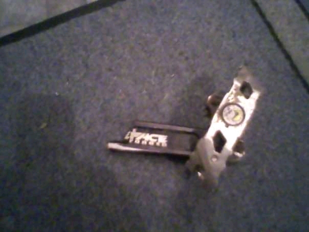

I have a SC Blur Classic from 2003 which is my main bike and i love it.
However, whilst out the other day, one of the cranks broke in two, its the one on the (3x) chainrings side.
I'm struggling to find a replacement crank as it needs the 4 arm spider attachment, see pic below. Originally it was a Raceface Turbine (forged). The bike uses an Isis bottom bracket if that affects anything!
Can anybody help me with what exactly i need and more importantly where i can get the part from?
Otherwise, it looks like my only option is to upgrade the groupset which is going to be costly, but cheaper than buying a new bike, which i dont really want to do!
[url= https://i.ibb.co/5Brbn1V/20220314-130750.jp g" target="_blank">https://i.ibb.co/5Brbn1V/20220314-130750.jp g"/> [/img][/url]
