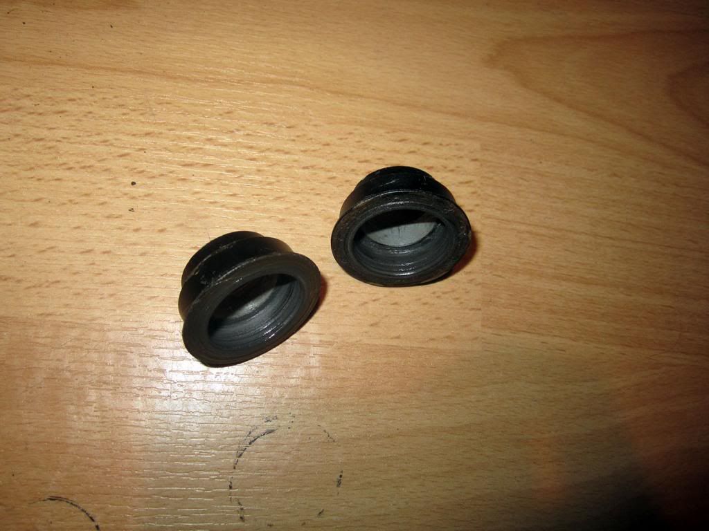

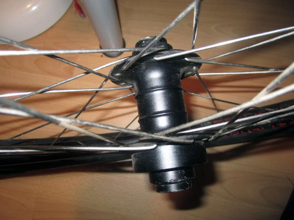

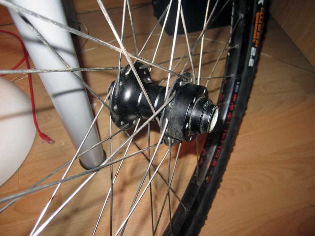

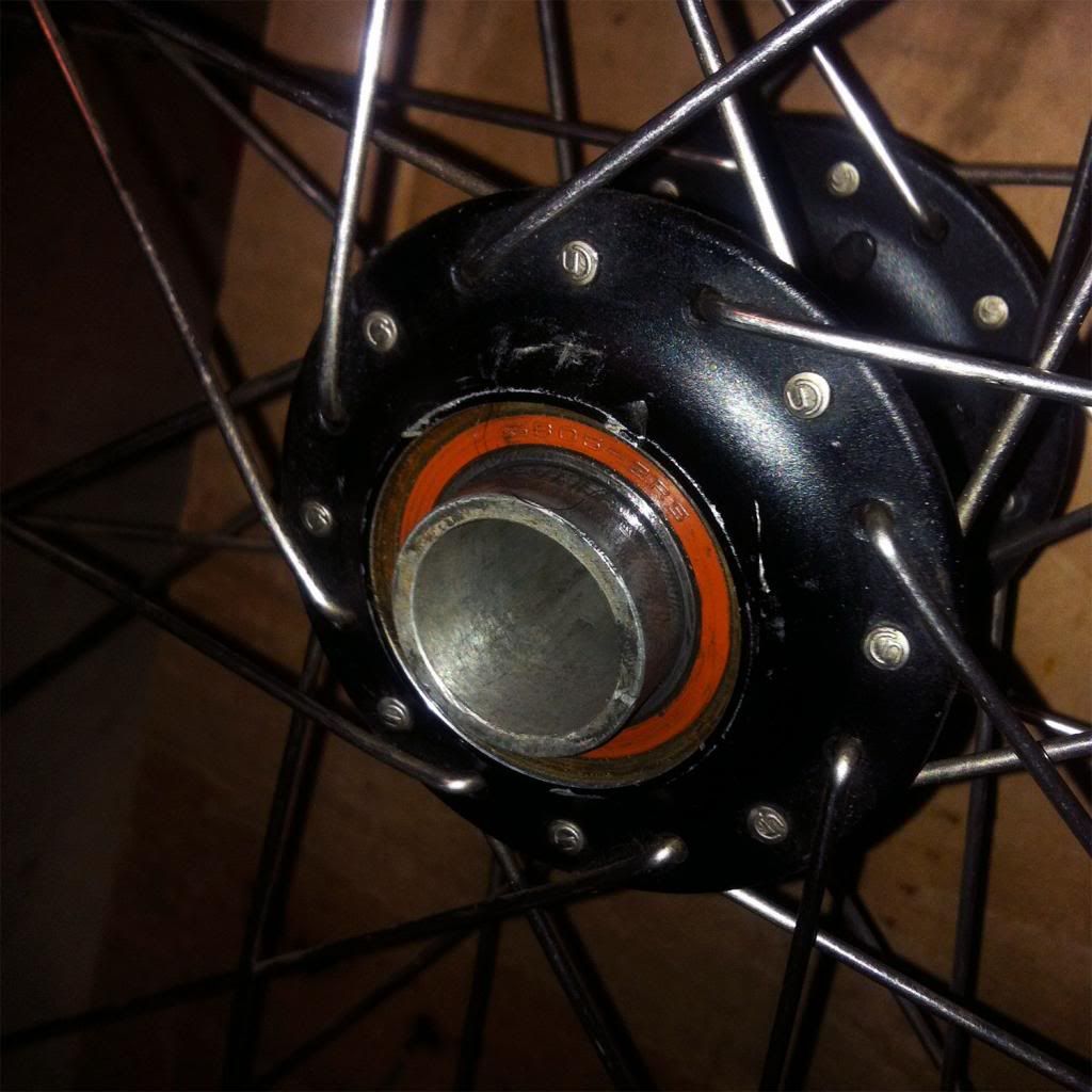

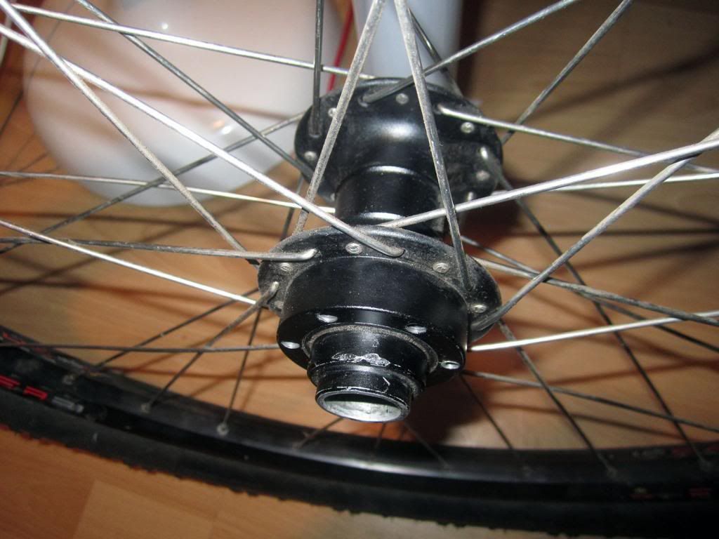

Hi There.. Recently got hold of some new forks, however they are 15mm bolt through and my front hub is currently set to 20mm. There are some manufacturers supplying conversion kits for their hubs but I have no idea what my hub is. It's on a Sun Ringle Equalizer 31 but has no branding on whatsoever. Any help would be appreciated.

I had a hub like that - it came OEM on a Kona Coiler. No idea of the brand though.

Would these take place of my end caps as well...

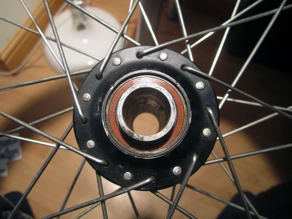

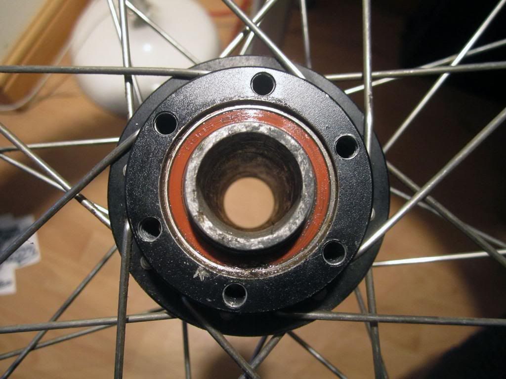

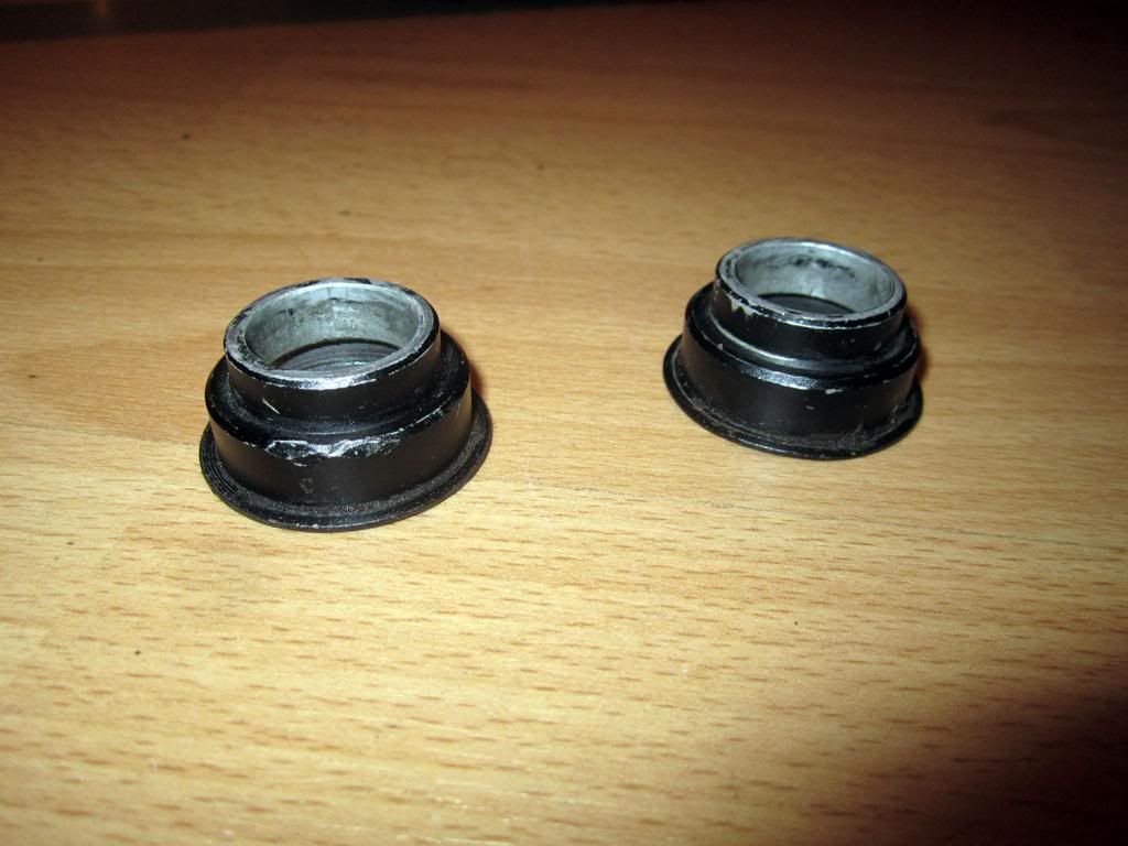

When you take my end cups off... My spindle protrudes around 10mm from the bearing and the below kit is designed to fit flush against the bearing.
So to me, it would make sense to cut the spindle so it ends flush with the outer bearing surface and this sun ringle reducer kit may do the job?

They look very similar to some sun ringle hubs I have, buts thats about all the info I'm basing my comment on.
I would try the jumping flea link from CRC first.
Sharkattack - thats just an axle not end caps. The sun ringle end caps linked look like the reduce the axle size down to 15mm as well as being end caps.

Best thing to do is see what bearing num it is put it in the net an see what others hubs use it like superstar au the inner an outer diameter will be the same so there caps should fit
