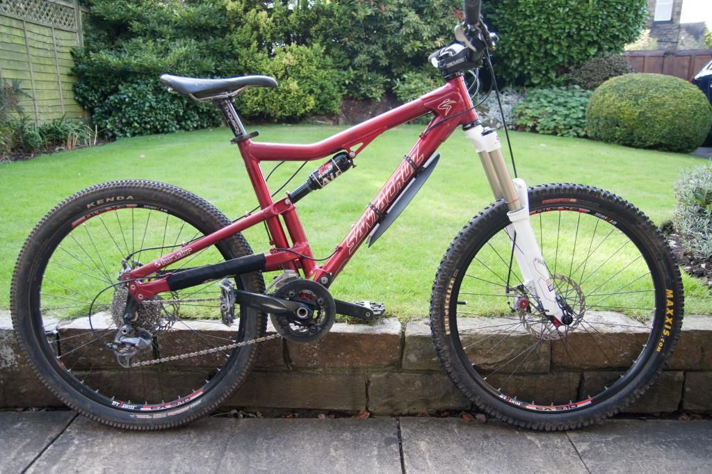

I'm in a bit of a dilemma so wondered if STW might be able to help me. This is what i'm riding at the moment.
the fork is a 150 Revelation RLT Ti which i love, shock is 5th Element Air - I don't know if it's any good or not as i've never tried anything different but it seems basic compared to taday's offerings.
I'm after something with a bit more climbing prowess. I live in Calderdale so there are a LOT of steep climbs and when it gets really steep i feel like getting out of the saddle and mashing the pedals but if i do this the back wheel lifts and i lose traction.
So basically it's just a bit slow on the uphills. For a while now i've been dreaming about a carbon 5010 but it's a lot of money and i'm concerned it won't be as much fun as the heckler, especially on the downs. So then i got thinking i might just get a new heckler. But then i thought that's basically what i already have! The only real difference that i can see (apart from a bit more travel and a couple of geometry tweaks) is the CTD rear shock.
So do i just try a new rear shock, or go for the 5010?
Will a new heckler be as good a climber as the 5010?
For 2K i also like the look of the Specialized Camber Evo, how will that compare with the heckler i'm riding?
So confused right now and don't have time to demo any of them 😯

3 bikes it should be really easy to demo. The Solo and the Heckler will ride very differently, having gone from a heckler version after your's to a Blur LTc and the VPP was just a lot better in every way for me. Better climbing, better grip, better descending.
Posted : 11/05/2015 11:24 am
I had the exact same bike/forks/wheels and improved it's climbing and DH ability with a -1deg works components headset. That made it a better bike for 2 years until I finally decided that a new bike was "needed".
Enter the Banshee Phantom, a much better bike in every way! The Heckler suspension design is pretty crude, modern shorter travel bikes (5010, Phantom, etc) use their suspension much more efficiently and basically allow you to have the benefits of short travel up hill without losing out going down.
But the slackset did allow me some breathing room to demo other bikes to get the one I wanted. May be worth a try given that pretty much any new bike purchase these days will involve a new fork and wheels to boot.

I have the one after yours without the gussetts. Hecklers are short in the toptube so will never be brilliant climbers. Getting a new shock with a proper tube may help, I got a cheap RP23 Kashima from CRC and got Loco to tune it. Wider lower bars help climbing IME. VPP will work better but you have to pay for it.

scruff the heckler would be the perfect bike for me if only it was a bit nimbler, i can't help thinking that shock needs an upgrade but the carbon 5010 R spec for 3K is really tempting. Trouble is they don't make them in this colour any more 😉

I still have the DHX5 coil that I used on my heckler up until I swapped bikes last July. A bit heavier than any air shock I ever put on it but also worked a lot better up and down.
Mail in profile if you are interested (I also have the works headset depending on the size of your frame.....)
I also found that an inline post (or smaller layback) improved uphill manners considerably.

I have the 2014 Heckler, if what you're looking for is something that climbs better than what you have then I'd give it a miss. Not that it's bad at it, but I doubt it would be any better than yours as it's nothing special going uphill. I love mine, but then I bought it for the descents!

The 5th element shock is massively outclassed by modern shocks. Swap it out, put a slavery on it and maybe think about some off-set bushes too. Nowt wrong with the frame, unless you want a new one?

I have just replaced a Heckler 6.0 and gone to a Bronson. Not the 5010 the OP was after but I would imagine my experience of the change to VPP and newer geometry could be useful.
As far as climbing is concerned the change is night and day. I never thought the Heckler was a bad climber but it did have a habit of lifting and wandering at the front when it got steep. I found myself using the launch control on my forks allot and dropping them down from 150 to 130mm to counter this. The Bronson on the other hand feels incredibly planted at the front. Back to back on the steep and sharp climbs we have locally there is a marked difference. Even with the 150mm Pike's at full extension it is noticeably better than the Heckler with the forks dropped. Grip at the rear with the VPP is also tenacious in comparison. When seated it just powers on up. Standing on the pedals was also something I avoided on the Heckler (with a simple Float R shock). All the power just seeped to be spat away losing traction. The Bronson on the other hand doesn't seem to mind a bit of pedal stomping.

Yeah that is really useful thanks Compass. I suspected the Bronson would be better at climbing. I guess the single pivot heckler is more heavily reliant on what shock it uses.
