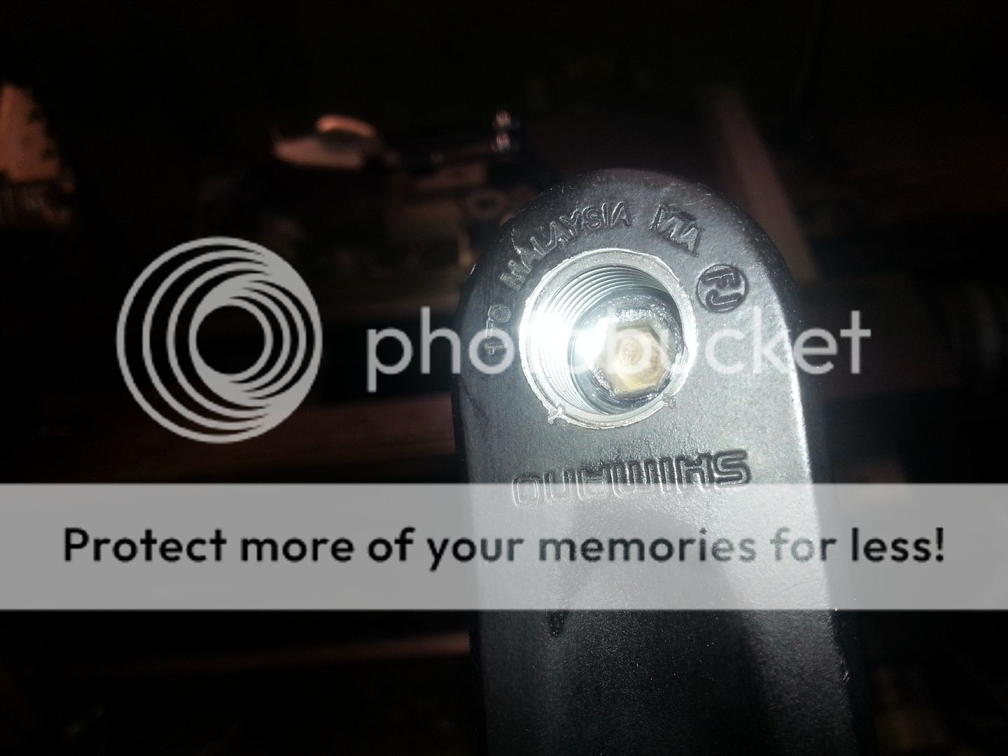

Posts: 479
right. you do not need an inserting tool because these are solid inserts, not wire ones.
job one - how to ensure you are perpendicular to the original hole?
[URL= http://i680.photobucket.com/albums/vv167/porter_jamie/20140509_173617_zps1923f87d.jp g" target="_blank">http://i680.photobucket.com/albums/vv167/porter_jamie/20140509_173617_zps1923f87d.jp g"/> [/IMG][/URL]
screw in a standard pedal tap and clock up and down and also around to get it flat and also concentric. i managed to get it better than 0.02mm so i can live with that. took a long time though.
then place oversize tap/reamer in with sprung centre to apply some pressure and ensure it doesnt go wobbly
[URL= http://i680.photobucket.com/albums/vv167/porter_jamie/20140509_173739_zps26f233a6.jp g" target="_blank">http://i680.photobucket.com/albums/vv167/porter_jamie/20140509_173739_zps26f233a6.jp g"/> [/IMG][/URL]
screw in insert
[URL= http://i680.photobucket.com/albums/vv167/porter_jamie/20140509_174814_zps551c1cc2.jp g" target="_blank">http://i680.photobucket.com/albums/vv167/porter_jamie/20140509_174814_zps551c1cc2.jp g"/> [/IMG][/URL]
now to cut to length. i have been thinking about this. the insert wants to be 0.5 to 1 thread below the face the pedal pushes up against, so i need to cut it down accurately.
[URL= http://i680.photobucket.com/albums/vv167/porter_jamie/20140509_175215_zpsc9ea6f89.jp g" target="_blank">http://i680.photobucket.com/albums/vv167/porter_jamie/20140509_175215_zpsc9ea6f89.jp g"/> [/IMG][/URL]
use a pedal axle - found a set of v12s in the box.
lathe is being used at the moment so i'll go and walk the dog and do it later. i reckon either loctite, or peen it to stop it moving. or both!
i will find an old BB, put it in the lathe and measure the pedal axle runout once done to see what's what when done.
Posted : 09/05/2014 5:25 pm
Posts: 479
trimmed it down on the lathe. Had to run it backwards and find a lefthanded tool to run upside down so it screwed it onto the axle and not off. Put it is into the crank with some retaining compound and staked it too. It actually feels really good. It tightened a pedal up fully stuck the pedal in the vice and really leaned on it. The pedal body was bending but the insert seems fine.
