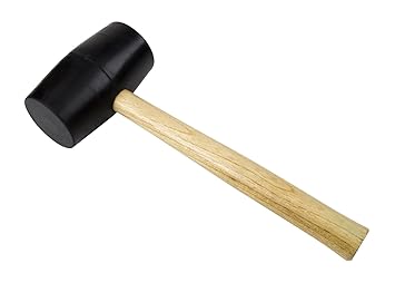

Oh yeha, I have a proper headset tool, and some threaded bar, but I use this:
Posted : 19/10/2017 2:54 pm
