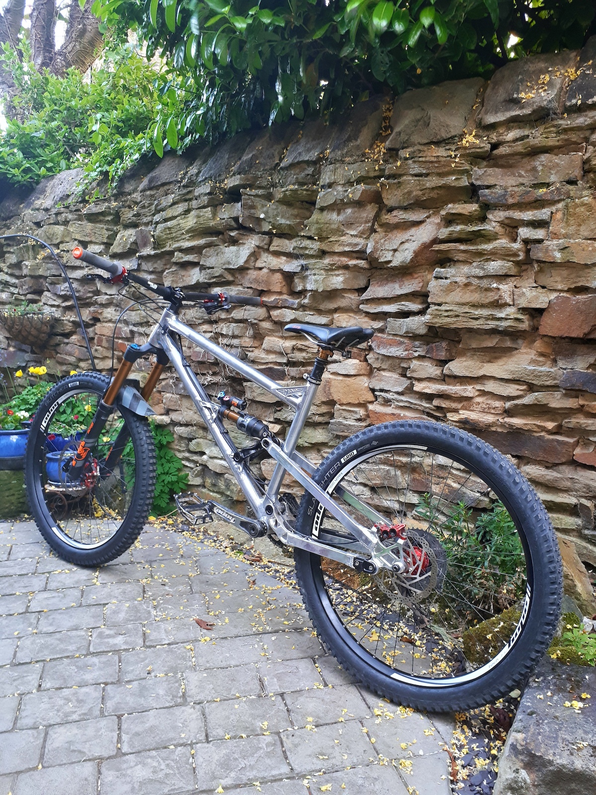

I did toy with the idea of selling mine a few months ago but it's got a tiny dent on the seat tube which annoyingly kind of kills the resale value even though it has no negative effect on the bike.
I think I'd rather ditch the RC2 fork which was never that impressive and switch to 29's as an experiment. When I sprung the cash for the G16 I still hadn't ridden a 29er that I liked so went full 27.5. Ideally I could have 2 sets of wheels in different sizes or try a mullet set up. One for mincing around the endless bridelways of the Peak and one for uplifts, bikepark and Alp stuff.
I don't have a recent picture but this is my frame. Think I've had it almost 4 years.
