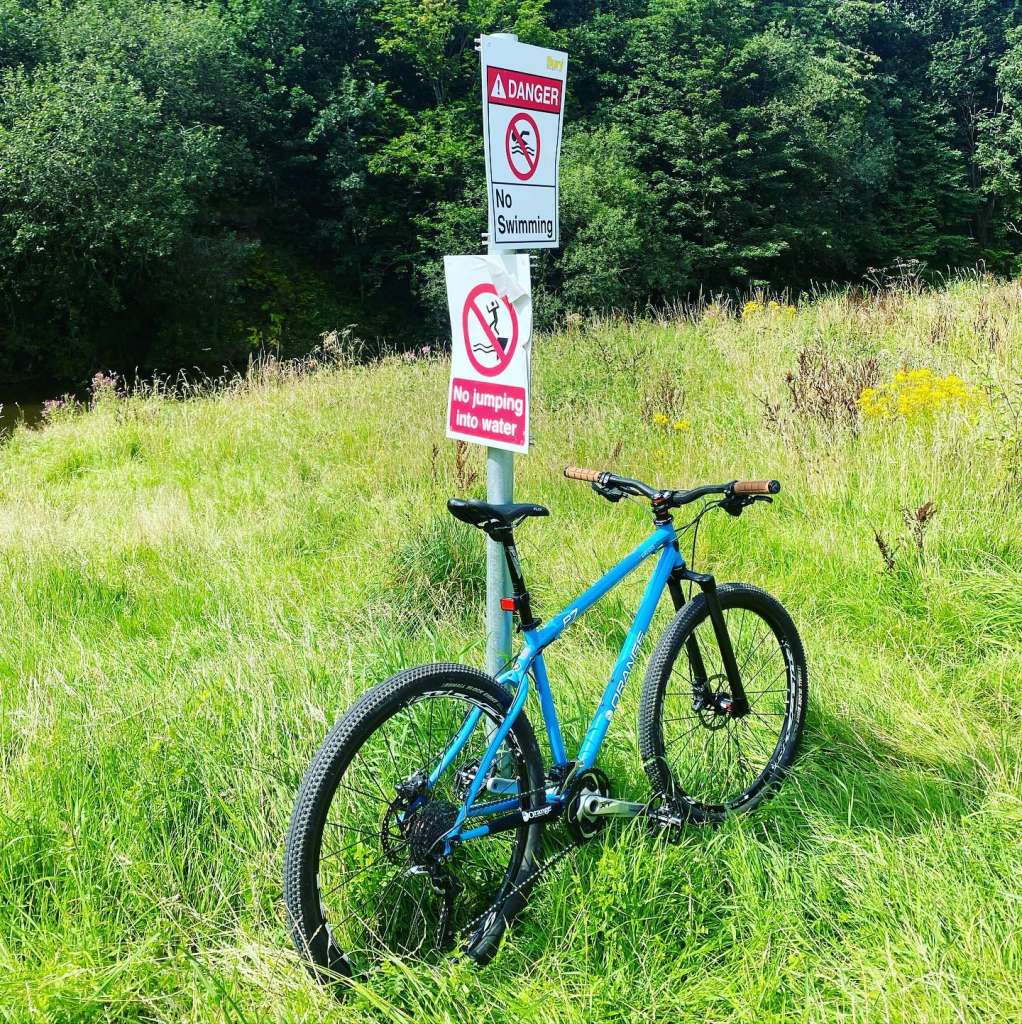

I've recently done the same with my old P7 to use as a gravel/commuter/pub bike (which actually gets ridden far more than my 'proper' bikes), but still running 26" wheels. I put the 26" Exotic carbon fork on and that will easily take a 650b front wheel. Theres bags of room.
You've got me thinking now....
