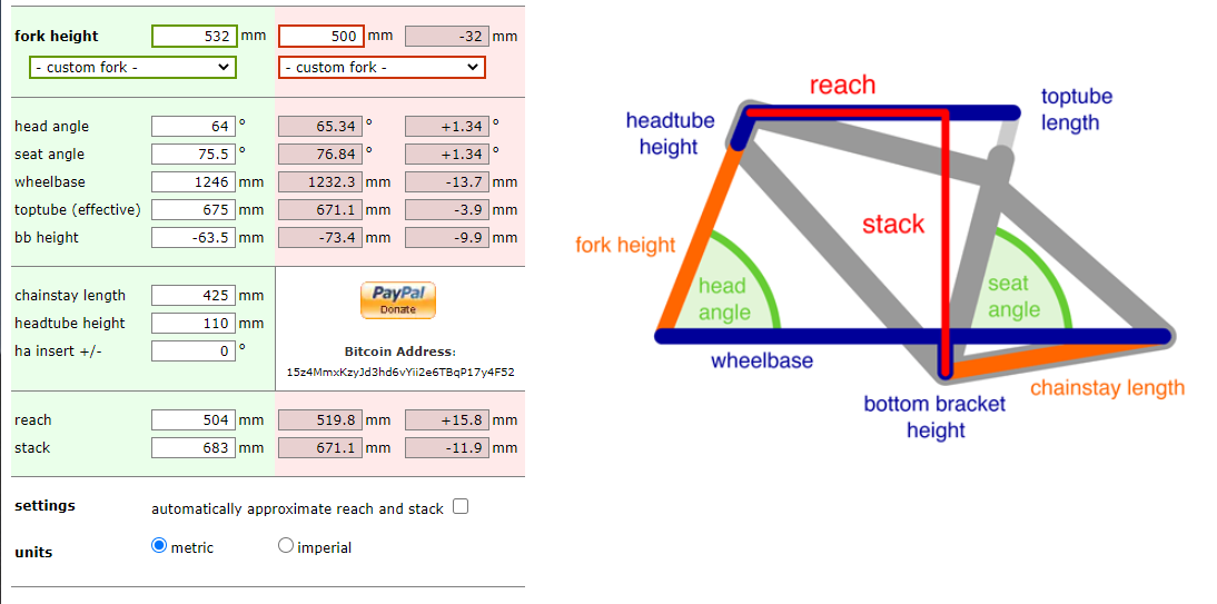

This is a really good site: https://bikegeo.muha.cc/
Lets you put in geo numbers and then alter fork length to allow for sag.
The Pace 627 with a 140mm pike, unsagged vs 32mm sag (23%):
So, 671 ETT (4mm less) and 520mm reach (15mm more) when sagged. I forgot that because the seat angle also steepens, ETT gets shorter.
Given your Reign has a 680 ETT and 495 reach, I'd still go XL. ETT is good for size when sat down, reach is for size when stood up.
The pace 627 will feel similar when sat down but a bit more roomy when stood up!
