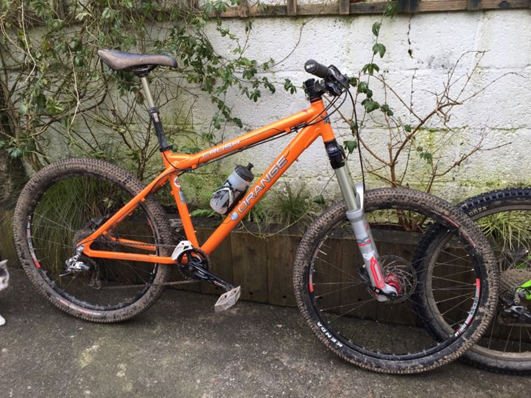

lyrik solo airs dropped to 140mm work well on my crush.
