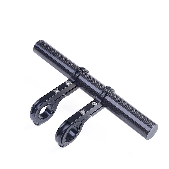

I need some more bar space on my bike as my Garmin interferes with my lifeline pavo light when they're both on. Can't move the light out anymore as it hits bar tape. I've seen some cheap handlebar extenders like the link below. Does anyone have any first world experience? The new bit of bar seems to be 22mm diameter which is considerably narrower than 25.4-31.8mm which the light mount seems to be able to accommodate with or without adaptors. Bodgeable with electrical tape/coke cans or too much difference?

Here's the picture from the link above.

I use one like that on gravel bike to strap my sleeping bag in a dry bag when I have needed more space..does the job.

I use one of these to mount my Exposure light - without it my cables/hoses obscured the light output due to placement of the cable guides on the sides of the headtube making the cables higher up that usual: https://www.ebay.co.uk/itm/175445324717. Extended bar section is 22.2mm - I bodged using rubber padding from various old bike lights. Too much diameter difference to build it up with leccy tape only. Holds my light solidly for MTBing with zero wobble:
